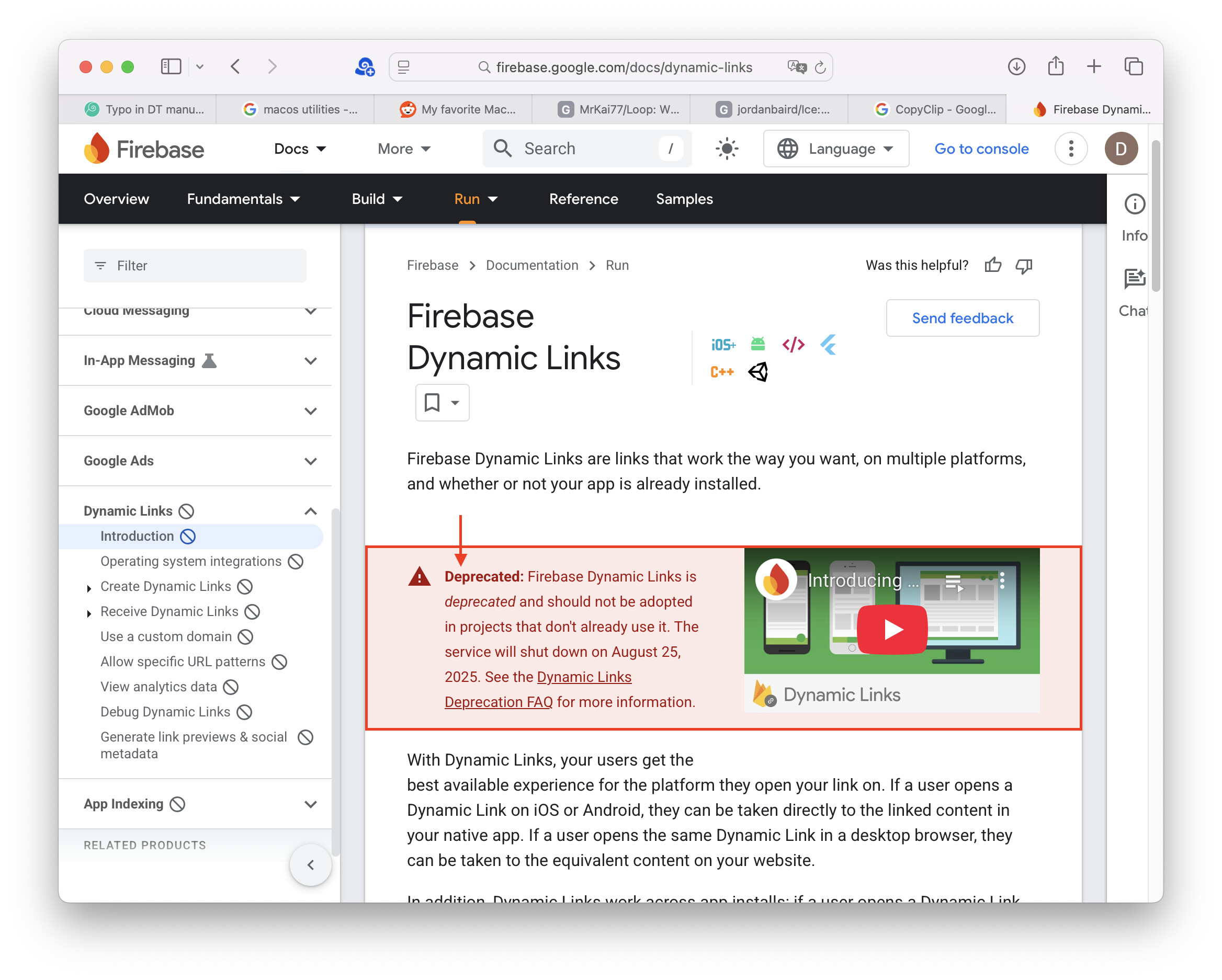

This script does not work for Firebase URLs which Roam Research and Tana use. I believe it works for URLs that end with image extensions like .png or .jpeg, but it fails when the URL doesn’t include an image extension. Is there any way to modify it to work with these URLs, or could you please share the script so I can customize it myself?
Are you referring to these…
Yes, I am.
If you don’t have a meaningful answer, then don’t bother replying.
The answer is meaningful. No one will bother to accomodate a deprecated technology. And a snappy attitude will probably not motivate more people to provide answers that you might consider “meaningful”.
And the script your referring to is not provided by DEVONtechnologies nor by a forum regular. Just raise an issue on its GitHub page if it doesn’t do what you want.
