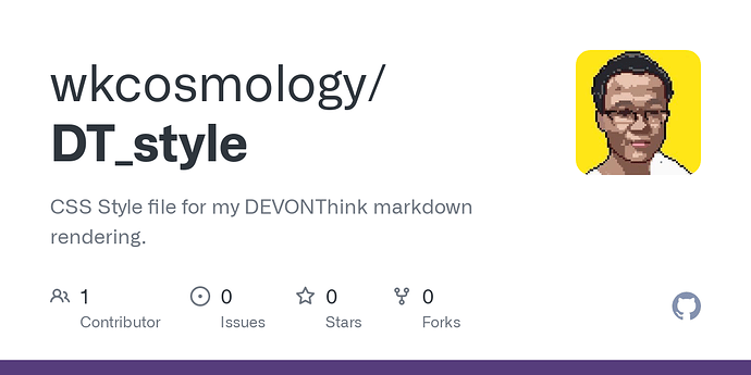

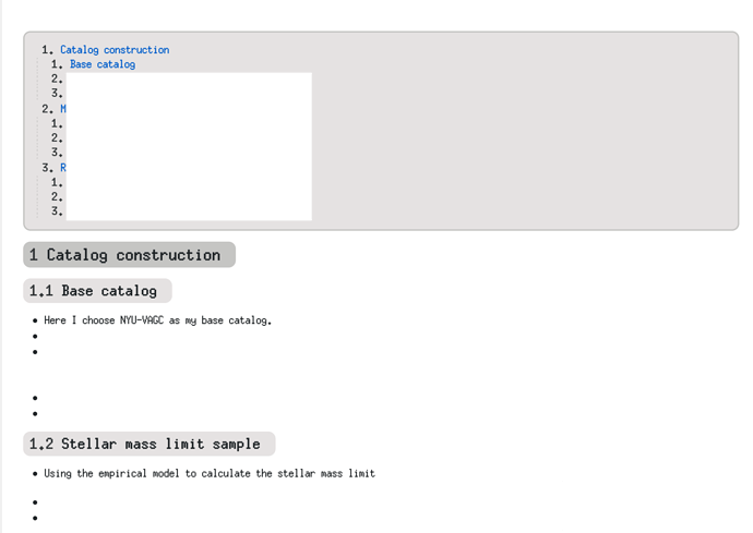

I want to share a markdown theme css.
I have the impression that this CSS is modelled after this 6-year-old (!) CSS sample github-markdown.css · GitHub (which in turn is using Bootstrap classes – no idea, why). If that’s the case, it would be the right thing to give credit where it is due. Even if the code is published on GitHub.
And, frankly, changing markdown-body to body does not make it any better. Nor does simply copy/pasting a bunch of rules that are presumably useless in the context of Markdown and DT.

I’d like to see an example Markdown file illustrating the CSS. And I suggest to really trim that code down. Even after a cursory glance, there are redundancies (like redefining kbd font and font size) and (I presume) a lot of unused and/or unusable rules in the context of Markdown styling. BTW: How do you even enter a kbd element in MultiMarkdown in DT?
In any case, you should think about using relative units in most cases. A “pixel” is not very helpful to size anything, given the vastly differing pixel sizes nowadays. Also, users can (and do) set a default font size in their browser for a reason. A style sheet should respect that and scale its fonts relative to the user’s setting.

I want to share my setting because I think there are someone who just want to copy and paste because they do not have time to write it. I use this theme for my work and I think it works fine for me and maybe others want it. I think we should have a place that we can just share my theme and others can just use it.
