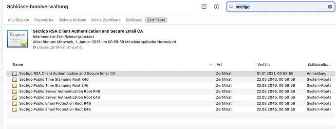

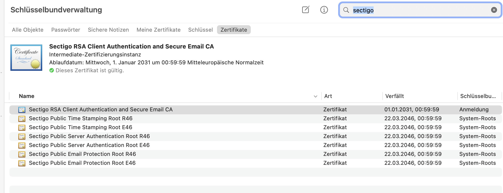

Interesting. It does so here (Germany, Safari Version 18.6 (20621.3.11.11.3).
Here’s what I see when I search for “Sectigo” in the macOS Keychain app:
Hmm. The exact same search gives me zero results.
(Denmark, Safari Version 18.6 (18621.3.11.19.1), Ventura 13.7.7)
I’m on 15.6. I guess that’s the reason. The intermediate and/or root certificates of Sectigo probably have arrived in the keychain somewhere between 13.7.7 and 15.6.
