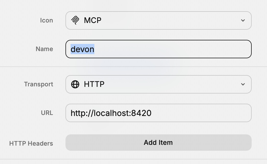

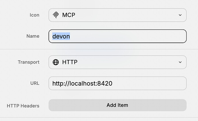

Did you manually edit the config file to accomplish this?
No, all I’ve done is shown in the screenshot. Just add mcp sever, everything is OK.

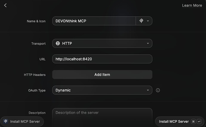

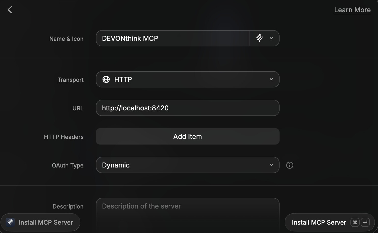

I am super pleased to have DEVONthink accessible via Raycast in a more extensible way than before. Thanks for showing how to set it up @ulmulm. I decided to create a quick start guide for the fun of it.
Configuring Your DEVONthink MCP Server with Raycast

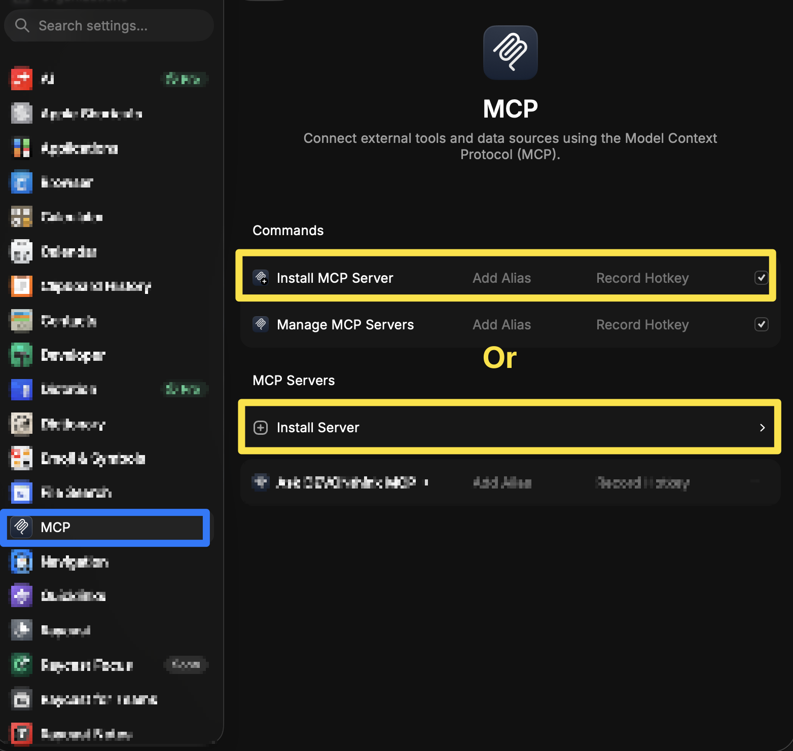

Assuming you have installed DEVONthink’s MCP server (using DEVONthink’s documentation, perhaps), and you have the server actively running:
  1. Navigate to Raycast Settings > MCP > MCP Servers > 'Install Server'. Or, simply use command 'Install MCP Server'.
  1. Fill in the required fields as below, and then ‘Install MCP Server’. You can use any name.
That’s it! Now just use your command. Mine is called ‘Ask DEVONthink MCP’.
Optional steps:
  • Pin the command as a favourite
  • Enable the command as a fallback for your searches
  • Give the command an alias and/or keyboard shortcut

And why are you using http instead of stdio ?
In any case, I haven’t had any issues using the Dynamic OAuth Type config. I avoided the static option assuming it would require credentials. :sweat_smile:
HTTP was the most intuitive to set-up.
Is it ignoring security entirely in that case? There is no DT4 callback URL for an Oauth page
