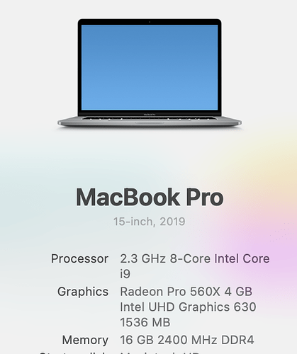

On what hardware? A Mac with a notch?
…no notch.
