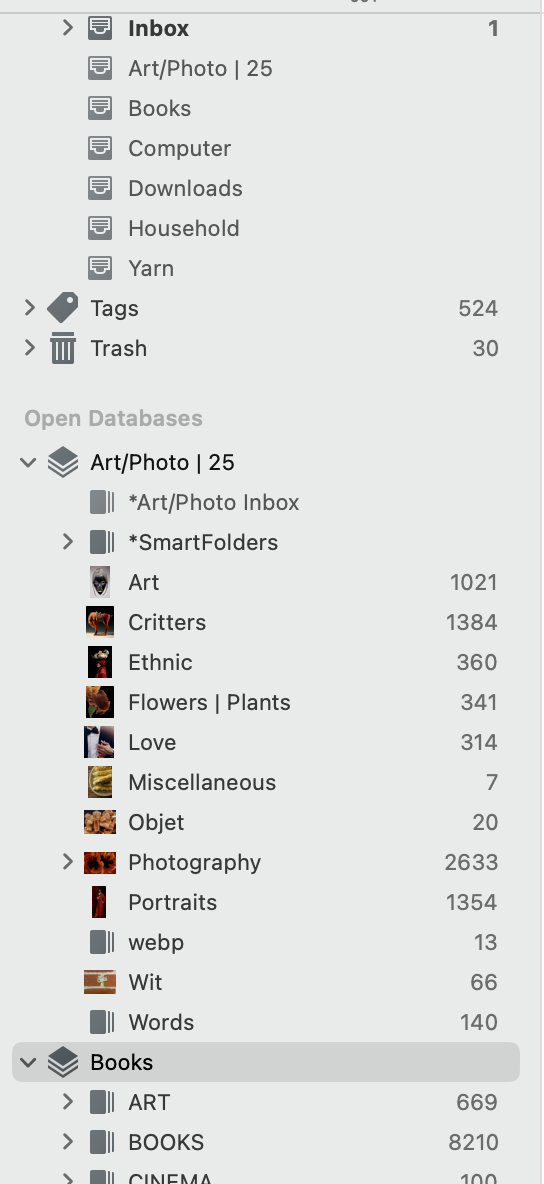

Can you post a screen capture of DEVONthink, including with the Globals section expanded?
The ones that are closed still have the internal Inbox.
The Inboxes are in the Globals section, unified (see Settings > General > Interface > Unify inboxes). And there is your Books Inbox and the Computer Inbox as another example.
Yes, they are up with the main Inbox, but they aren’t in each database, like they were before. ArtPhoto is up above and in the database, Books is up above, but not in the database. I’ve been accustomed to putting things in the database Inbox for distribution – not up above.

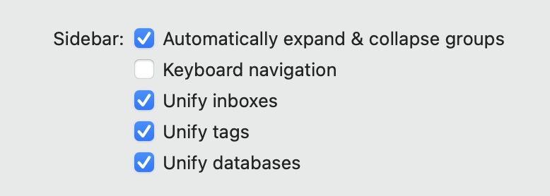

Never changed it; must be default because I didn’t know what it was for :slight_smile: . Here it is:

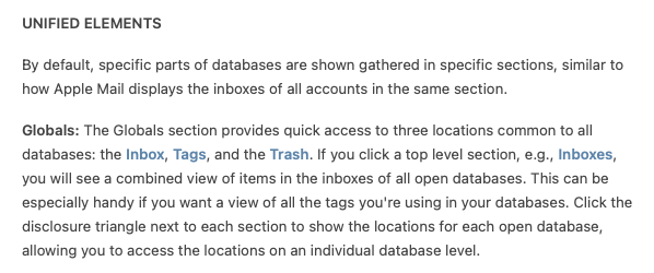

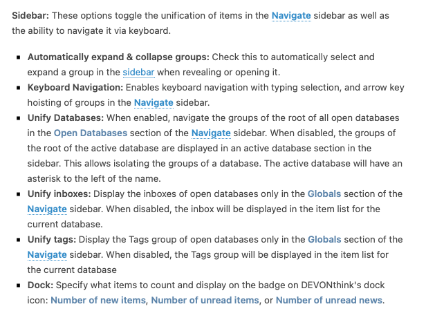

Clicking on the “?” in bottom left corner of that dialog box will call up “Help” on that dialog box and you can read what “Unify Inboxes” means.
Try it check “on” vs. checked “off”. Behind the dialog box, DEVONthink will change the view of inboxes. Position the dialog box so you can see the changes. I think you may find what you are looking for.
Trying to clear up confusion about unified tags, basically the same:
The inboxes are still part of their respective database, they are just displayed together in the sidebar.
Unchecking “Unify inboxes” should give you what you want.
I don’t know why you also have a group called *Art/Photo Inbox – but look at the icon, it is a group, not an inbox.

I’m guessing you may have deliberately or accidentally renamed the Inbox in “Art/Photo” database at some point. A guess, of course. And special characters in group names and database names “*” and “/” … something I would avoid but shows my age in avoiding special characters like that which may confuse the file system.

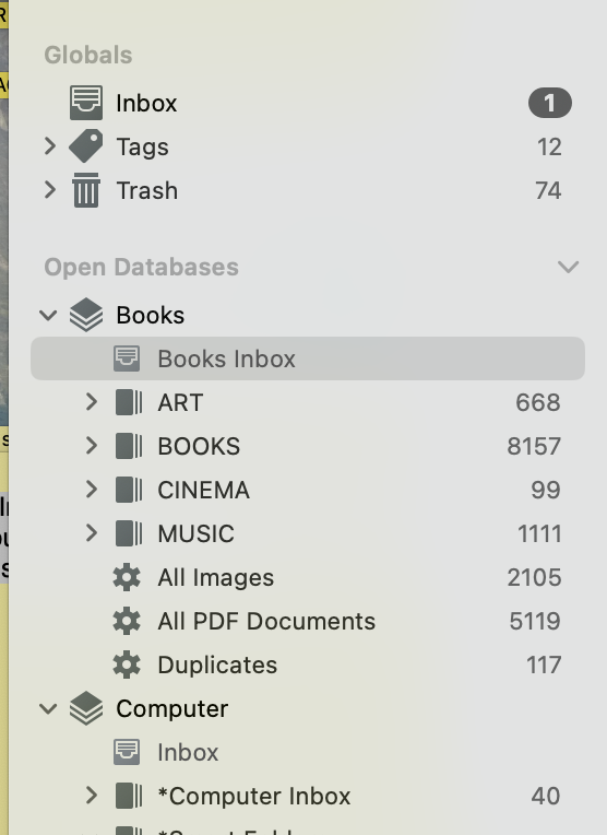

During all the years I’ve worked with DT, the Global Inbox showed all open database inboxes, and each database had a visible, functional Inbox at the top of the Group hierarchy. I never touched the Unify inbox option; had no reason to read about it or do anything with it; everything seemed fine.

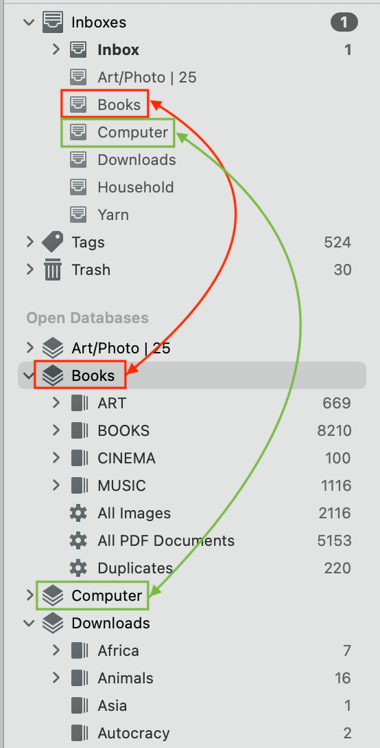

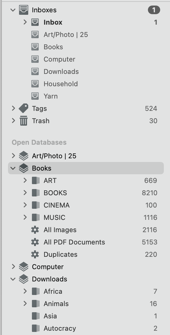

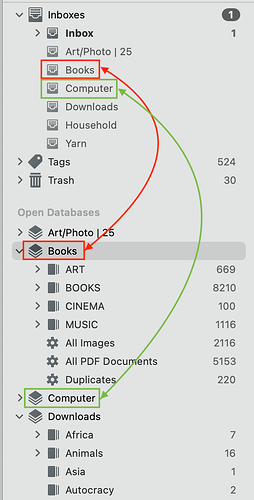

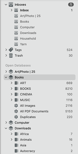

First screenshot is of the left panel with Unify inboxes checked. There are two open databases. The Global Inbox shows both of the open database inboxes. However, in the database, “Books”, no Inbox is visible. In the database, “Computer”, the Inbox is visible.

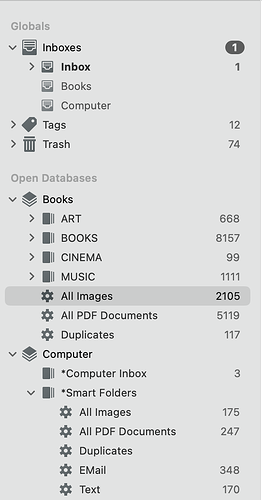

Second screenshot is with Unify inboxes unchecked. The Global Inbox shows no inboxes for the two open databases. In both databases, their Inboxes are visible – Books now has one, which it didn’t before. Computer still has one – (so, regardless of whether Unify inboxes is checked or unchecked.)
Books is a new database (the original was corrupted). I used the Import command to bring in all the files I’d saved in Finder. This is not the only corrupted file I’m dealing with – I created another new one, and imported it’s files, and it is behaving just like Books. I created another one that is empty; same situation.
In summary, My older databases have visible inboxes regardless of whether Unify inboxes is checked or unchecked. In the new databases, the inboxes are only visible if Unify inboxes is unchecked.
That the databases are behaving differently is the issue – they should all behave the same way, yes?
I doubt that „Computer Inbox“ is what you believe it is. Check the icon.
