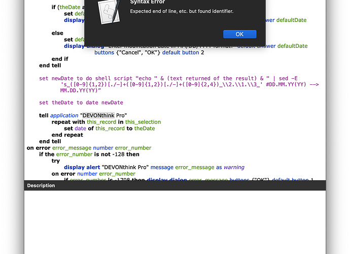

As for the script, i’m almost certain that I’m pasting it into the right place, but I’m getting the error on saving/compiling “Expected end of line, etc. but found identifier.” and DEVONthink is selected. Any ideas as to where I messed up with the addition?
Post a screencap, please.
Okay, there’s one of the error and one of the entire script. Any on ideas what I messed up?
Yep. As I expected, the last quote in the shell script line is a typographer’s double quote, not a straight double quote.
