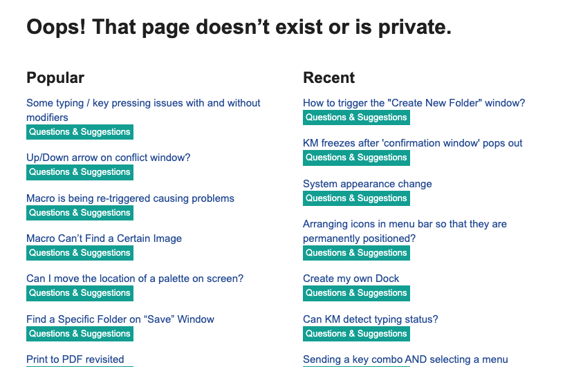

Hey thanks for the reply Roilan. I went to that link though and it didn’t work?
