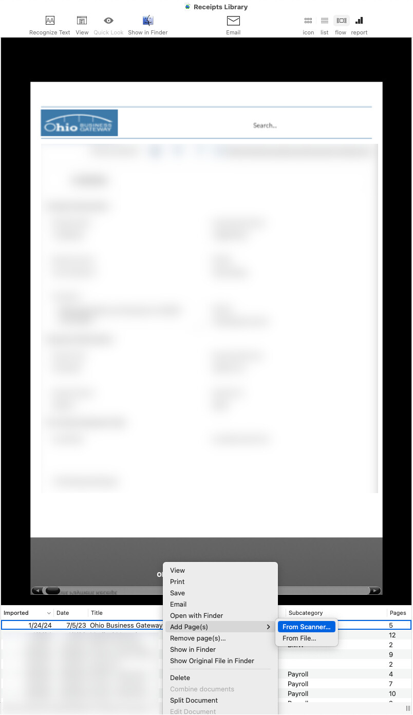

Is there a way in DevonThink to add to an existing .PDF from the ScanSnap scanner? This was a feature in Paperless that I used all the time. I know I can scan seperately and then move the newly scanned page or pages into an existing document but if I could scan directly into the existing document it would save a step or two.
View > Sidebar > Import > Image Capture offers such a possibility but this is limited to scanners, cameras, iPads/iPhones etc. which are compatible to image capture and the ScanSnap isn’t. Therefore the easiest option is to merge the scans, see Tools menu.

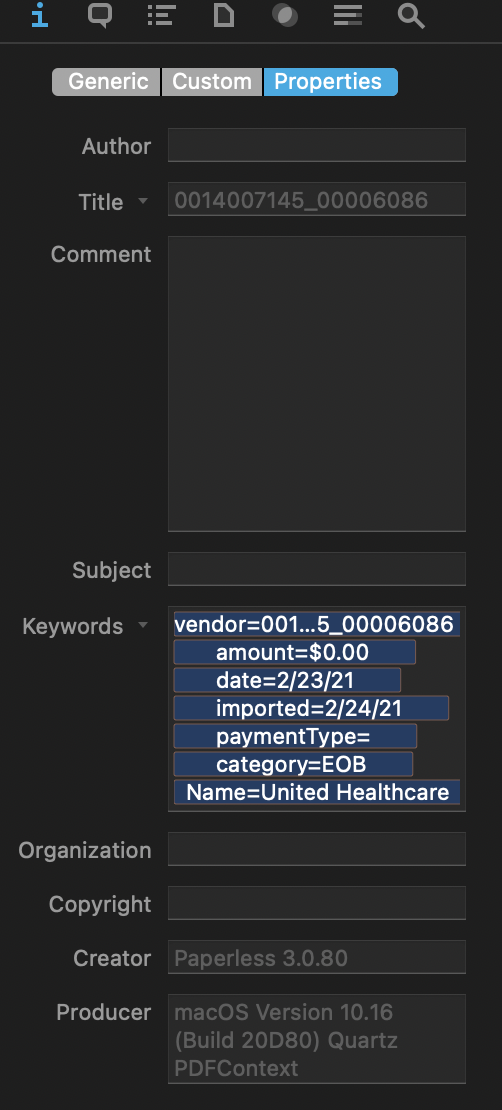

Sorry, very new to DevonThink. Here is how it is importing. I’m trying to get the name and date to import into a useful form. (The category is already also listed as a tag (which is great). If there is an easy way to have the name and date be either the record name or a custom field that would be great. Really appreciate the help.
These are PDF metadata, I’d say. And since the script doesn’t do anything with them, these keywords are probably already contained in your original PDF.
Edit See post below for a better way, avoiding PDFKit
For that, you’d have to read the PDF metadata field “Keywords”. That is possible using Apple’s PDFKit framework: You have to read the PDF into a PDFDocument object, get the documentAttributes dictionary and retrieve the value of the PDFDocumentKeywordsAttribute key from it. That should give you an NSArray with the “keywords” as NSStrings. In this case, every keyword is a key-value pair. Looks terrible to me, but at least it’s a lot easier to retrieve than XML data or whatever else people put in their PDFs nowadays.
As I said: It’s possible. But I’m not going to write that script. I suggest searching in the forum for PDFDocument, that might return some posts with sample code.
In my previous post, I was a bit off target. DT records have a metadata property that should contain the keywords in your case.
So, in the function addDocument, add this at the end (not tested, since I don’t have appropriate documents), replacing newRecord.name = title;
const keywords = newRecord.metaData().kMDItemKeywords.split('\n');
const kwName = keywords.filter(k => k.includes('Name');
if (kwName && kwName.length) {
  const name = kwName[0].split('=')[1];
  newRecord.name = name;
This snippet assumes that
  • the metaData property contains a kMDItemKeywords key. If that’s not always the case, you must check for its existence before applying split to it.
  • the kMDItemKeywords entry contains keywords separated by newlines. If that’s not the case, change split('\n') accordingly
  • the Name entry in kMDItemKeywords contains the name you’re after
  • The string Name and the name itself are separated by a = sign. If that’s not the case, change split('=') accordingly.
