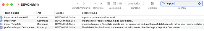

And the error occurs here:
with the message 1708 - Message not understood. One of the particularly unhelpful OSA error messages. In general, it means that you use a method (aka ā€œcommandā€) that does not exist. In this case, it’s import. That one went down the drain, it appears, with DT4. As a look in Script Editor’s scripting dict tells you:
I suggest changing that line to
const newRecord = app.importPath(path, {to: targetGroup});
and see where that gets you.
