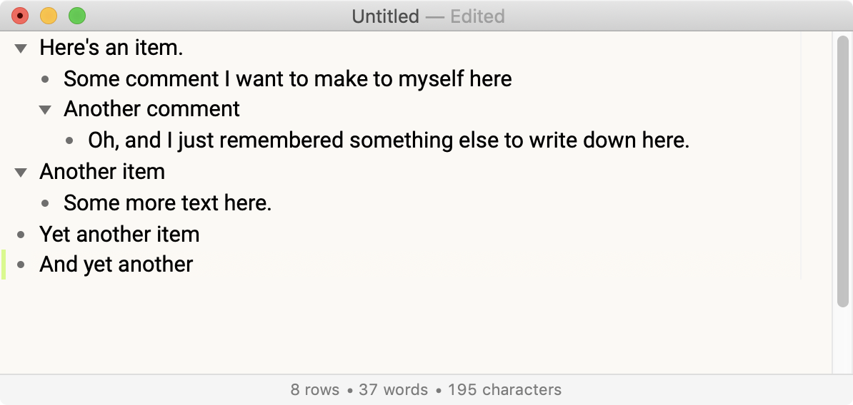

One of the features available in an outline-oriented application like OmniOutliner is the ability to move outline elements around using keyboard shortcuts. You can write documents in simple outline structure, such as this:
and move elements around without taking your hands off the keyboard by using OmniOutliner’s keyboard shortcuts,
making it so easy to rearrange the structure:

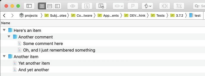

And like so…
In a truly blinding flash of the obvious, it only lately occurred to me that I could approximate the outline style using DEVONthink groups and the list view

Right, it would only work in unsorted mode. Regarding the screen capture, I’m not sure what we’re seeing – do you have some kind of keyboard shortcuts to do that already?
Thank you for bringing that up – it was on my mind but I didn’t write it. This approach definitely seems to work best with short notes, as you say. I’m currently also experimenting with using DEVONthink’s “widescreen” view (⌘7), so that the outline and notes are side-by-side.
