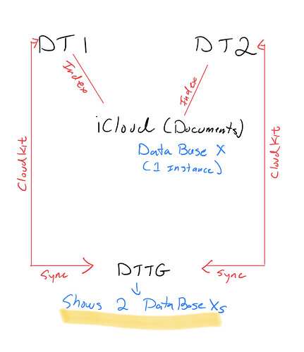

Below is drawing that hoefully explains my current sync setup. And, yes, DTTG displays 2 seperate databases based on the single iCloud instance. I am sure I have something poorly configured. Should I remove one leg of the CloudKit sync?
If DEVONthink To Go - or DEVONthink - shows two databases with the same name, they are not the same database and will not sync together. Creating a new database with the same name will never work as it’s a new and separate database, regardless what the name is. Only true copies of a database can sync.
