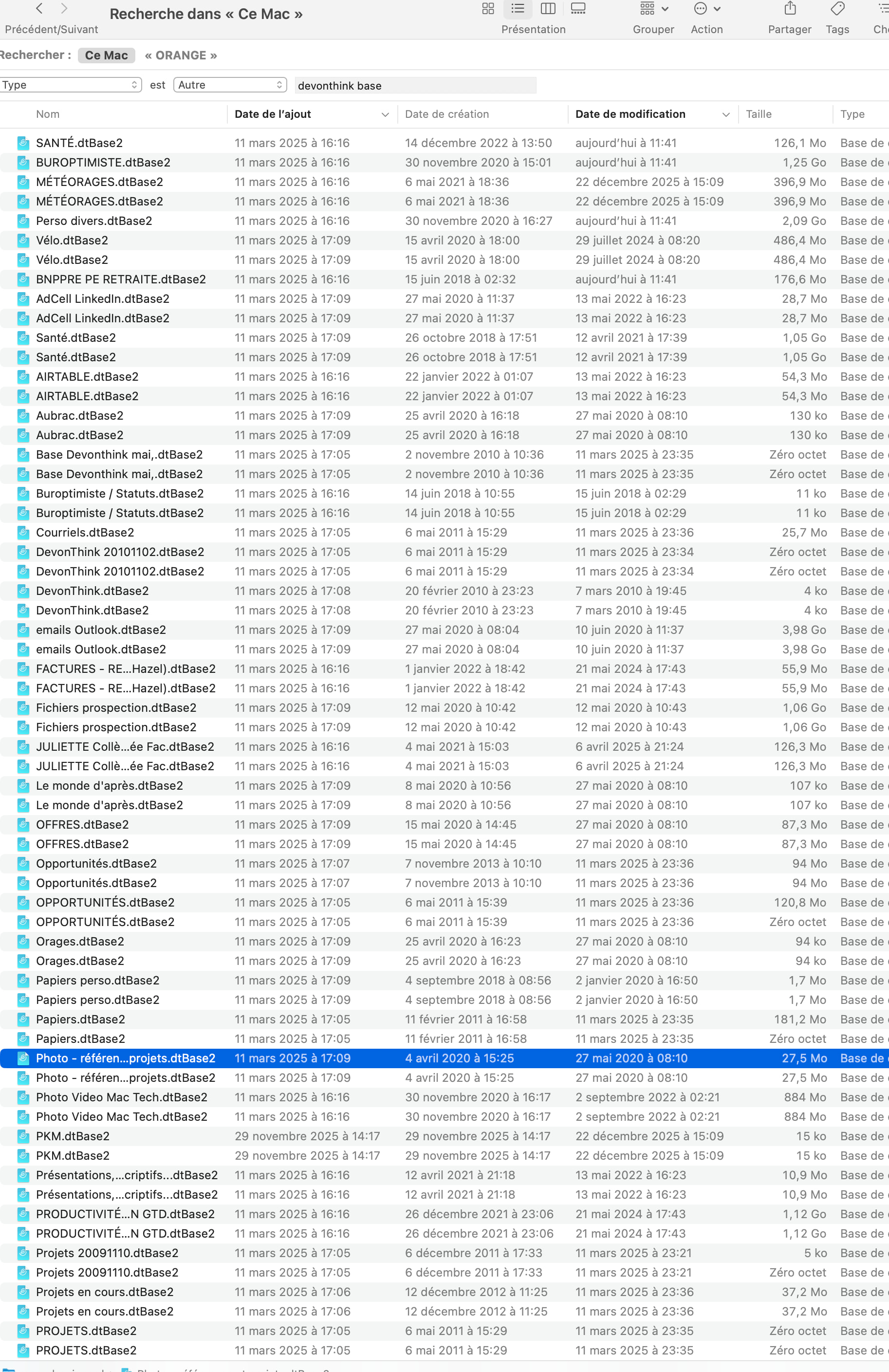

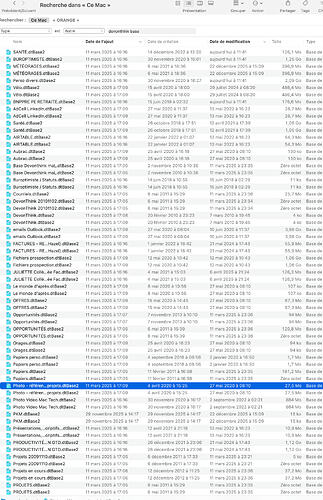

That’s before migrating, on my “source” iMac. Seems strange to me too. Screenshot here attached.
So, it has nothing to do with migration – you have duplicated databases on your old Mac. Apparently in the filesystem, assuming that the screenshot shows a search result in Finder.
I suggest that you look at the folders where these duplicates live
Indeed, the location isn’t shown in your cropped screen captures. Choose View > Show Status Bar in the Finder, then select one then the other database in a pair. Where are they each located?

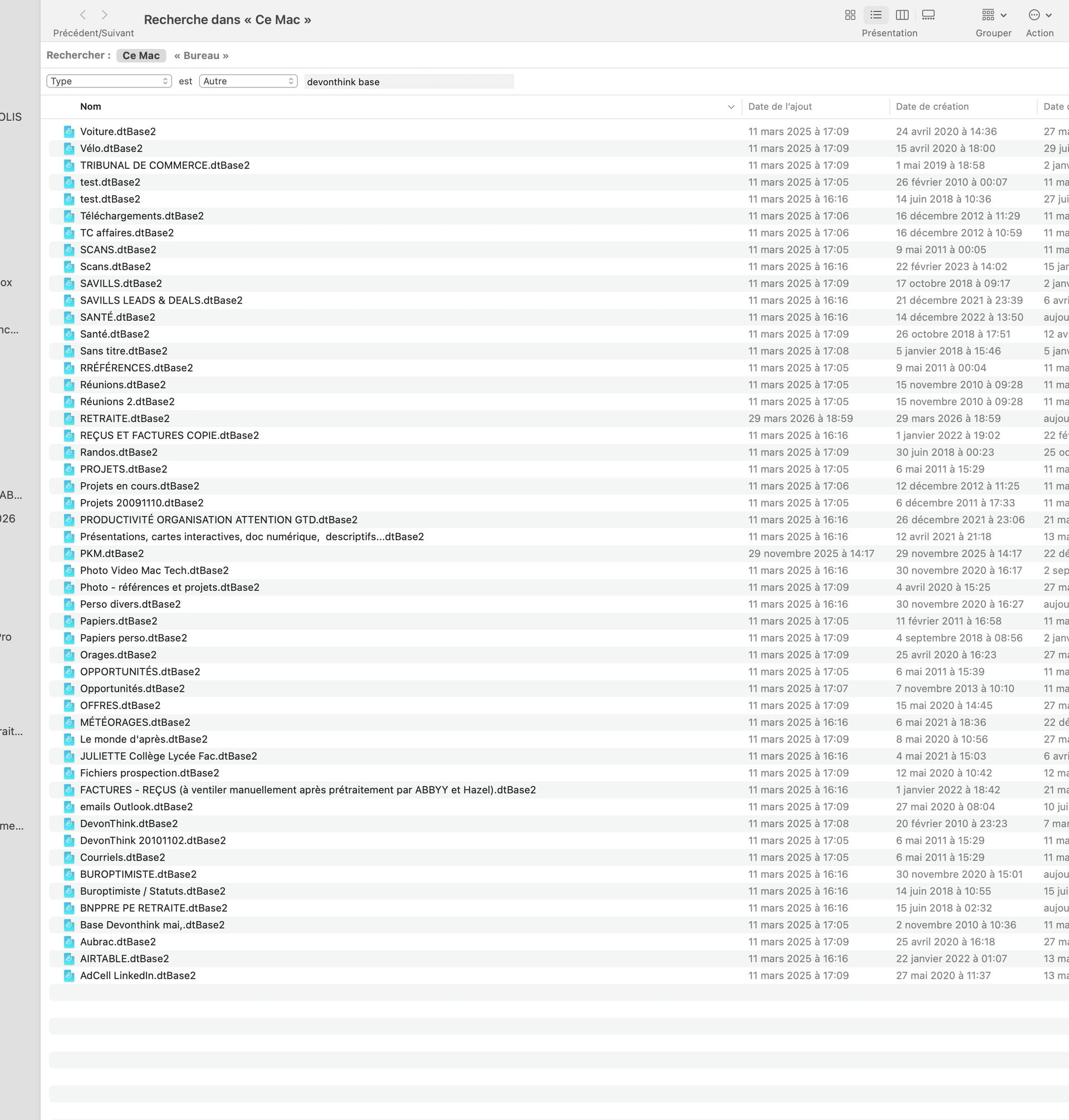

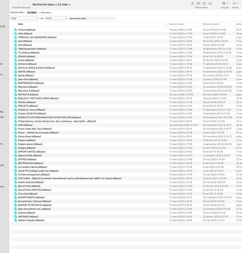

Well, that’s crazy. I did the exact search this morning in order to answer to you… no more duplicates :flushed_face:
So it seems it was a non issue on DT side, maybe an issue with the finder itself ? I don’t understand.

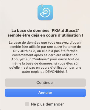

BTW, it’s another topic, but what should I do why getting this message saying the base is already in use ?
Press Continue. Is there a crossed pencil icon to the right of the database’s name in the Navigate sidebar?
No, I don’t see one. I frequently had this message in the past, what should I do when it happens again ?
It depends on the situation. A database rebuild may resolve it but if it’s from Migration Assistant or a Time Machine restoration, it may require a bit more effort. In those cases, open a support ticket.

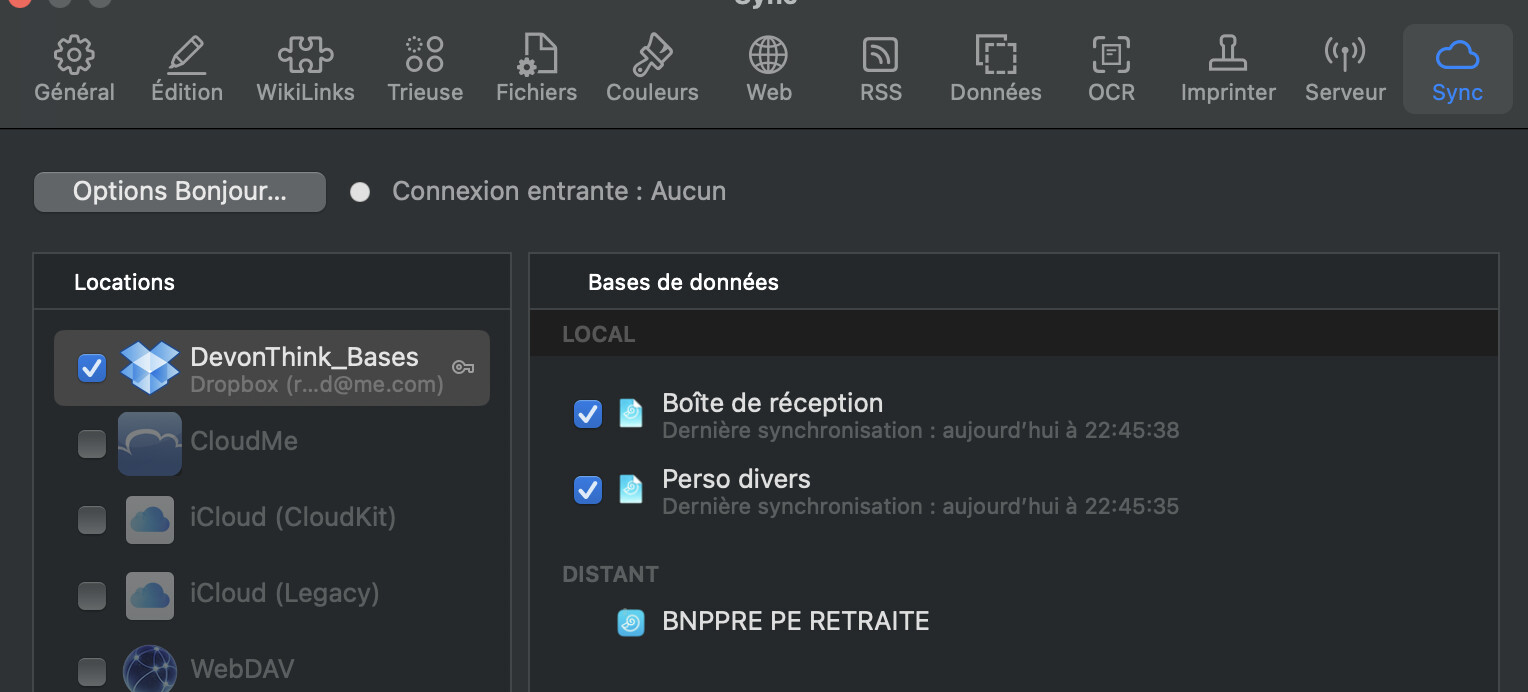

As I’m keeping the ‘old’ one, and do not migrate the whole Mac, I choosed not to transfer the bases, but to sync them with my ‘new’ Mac.
I’ve read in your migration tutorial the issue regarding files indexed -instead of imported- in the source base, who will not be migrated. Will I have the same issue when syncing, I mean files indexed in the source base not synced to the new Mac ?
Which would mean that, as long as need files accessible outside of the main Mac, it will only work for imported files ?
