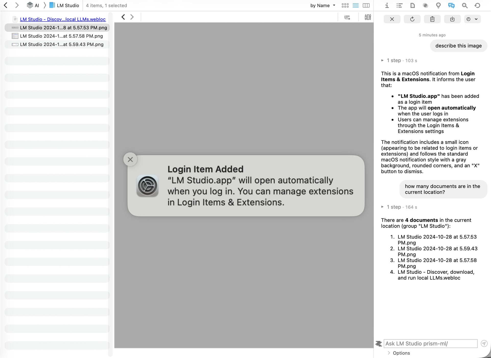

Here is an example naïve query with LM Studio on a document and the current location…
