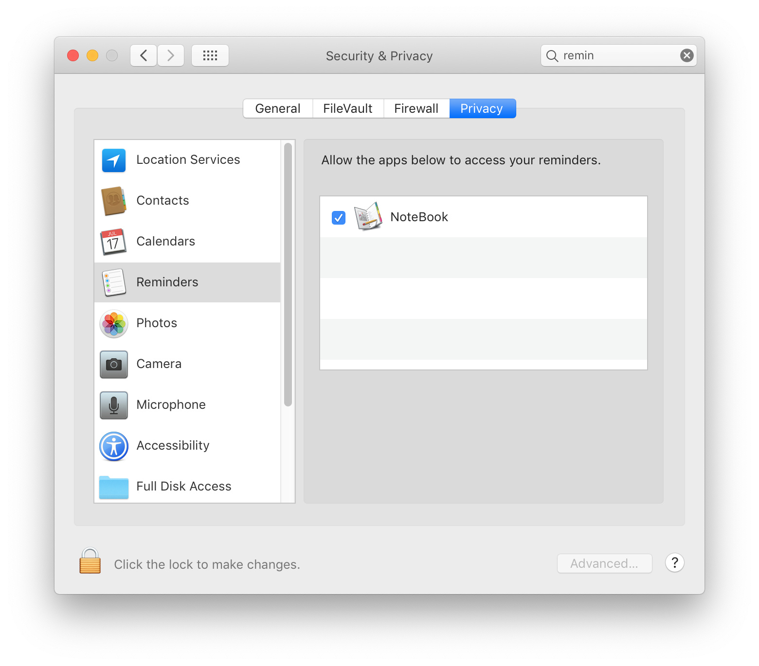

Theoretically it should be enabled in the security and privacy control panel.
(Mojave shown)
But, there’s no entry for Devonthink, and, no widget to add more apps. That may be because my copy of Devonthink has never asked.
