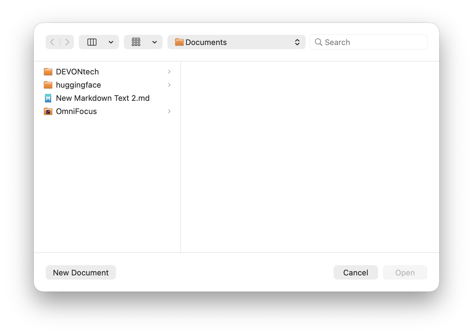

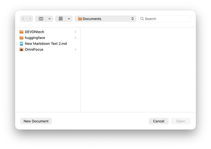

Well, what happens when you launch Numbers… ? This… every time.
Add this as the second line of your script…
tell application "Numbers" to launch
This doesn’t put up the bothersome Open dialog but silently launches the app in the background. How does it behave for you now?
No Jim, I don’t see that Open dialog each time my script runs.
I used to when I had this code in my script:
-- ensure that Numbers is running
-- this was causing a problem: brings up a dialog to select a document
-- so, I dropped this code 2020-10-13
tell application "System Events"
  if not (exists process "Numbers") then
    tell application "Numbers" to activate
