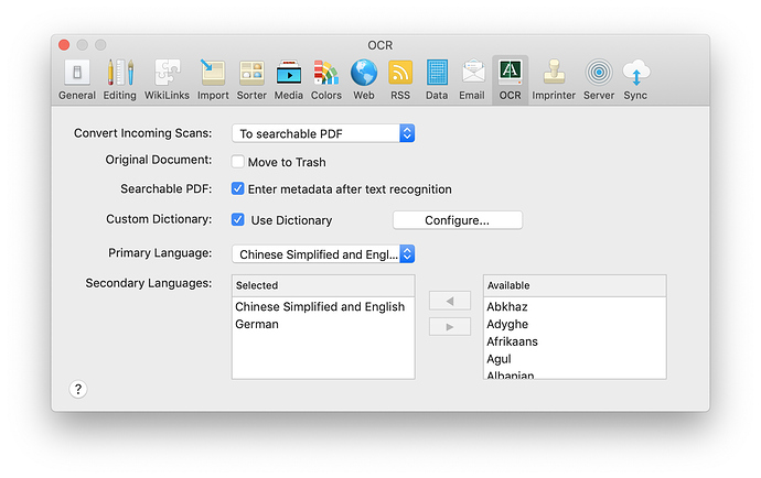

I converted a screencast into searchable PDF via OCR with a setting as follows.
But I couldn’t search any Chinese characters in it after adding some highlights and annotations. And the OCR option in the context menu came valid again.
