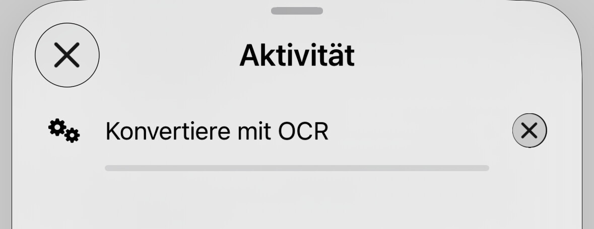

A screenshot to supplement the topic.
The process does not progress and remains in the pop-up. This is also the case when attempting to terminate the process.
The message remains even after closing the programme and reopening it.
