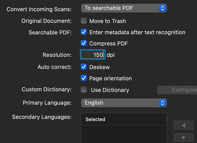

What are your OCR preferences?
Here are my OCR preferences:
What does the Producer entry say for the OCR’d document? If it says “… Quartz PDF Context” the document has been resaved after OCR, this usually happens to transfer annotations or metadata to the new document. This is done using Apples PDFKit which does not provide the same level of compression as ABBYY.
