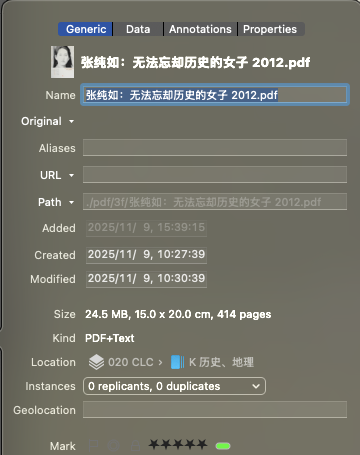

I have an OCRed pdf file downloaded from Internet Archive. The source file size: 25M
20251201 began to read on DTTG4.0.1, made 9 annotations, and synchronized back to the computer that night.

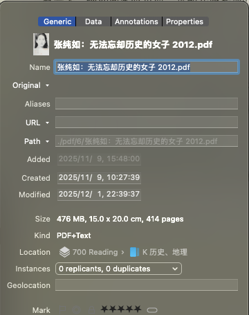

20251202 updated in the morning. After the new 4.0.2, I found that it could no longer be annotated (text, HL, etc. could not be selected). (The problem was found to occur at DT4 at the end)
Kind is still PDF+Text.
At this time, I found that its size had become 476M. After checking the file size on the computer, I could be sure that 20251201 had become so large!

  • I re-imported the source file (25M) (4.0.2) and made some annotations on DTTG4 (it can be annotated normally at this time). Synchronized back to the computer, I found that the file size has increased again (460M), but strangely, DTTG4.0.2 is still 25M, so the problem lies with DT4. When I synchronized back to DTTG4 again, I found that I couldn’t make annotations again.
  • I imported the source file to DT4 again. After directly annotating, I found that the file size had also increased

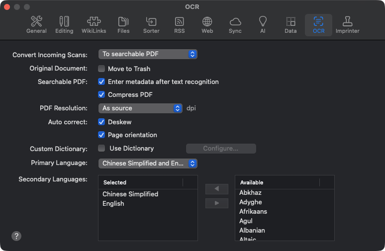

  4. Your OCR settings in DEVONthink matter.
Original document: 19.3MB (568 pages with a text layer).
After adding a highlight in DEVONthink 4 and saving: 68.7MB
The document contains very aggressive JBIG compression.
After the annotate and save, the JBIG compression is re-encoded with JPEG2000 (JPX encoding) compression, a much less aggressive form.

For point 4, please refer to the figure below.

Also, using PDF Resolution: As source is inadvisable unless you scanned the document or actually know the resolution. It in not uncommon for people to scan at too high a resolution and that setting will preserve that resolution, increasing the file size even more. I’d recommend 200dpi as a balance between quality and file size.

Thank you for your suggestion to PDF Resolution. In the past, I have tested more than a dozen documents, 200dpi and As Source, and the latter can maintain a smaller file size more often. Maybe the file I got is more suitable for this setting. Thank you.
