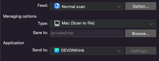

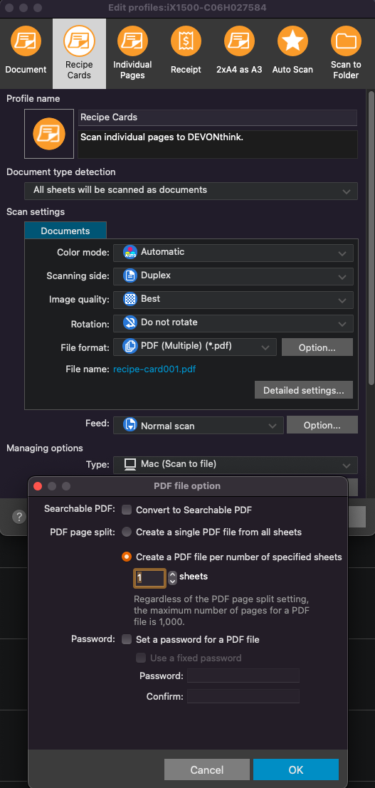

I’m importing multiple single-page documents from ScanSnap, and have it configured like this.

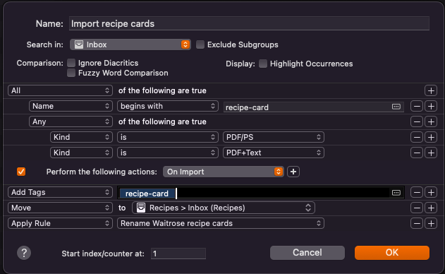

and in DT4, I have this rule:
When I load six documents into the hopper and press the Scan button, I get six PDFs. All have names starting with recipe-card. But DT4 only runs this rule on the first of the batch — I have to select the other documents and manually run this rule against them.
I’m not sure if there’s something wrong with my setup, or if this is a bug. It’s been this way for a few months, but it’s still occurring in DT 4.2.2.

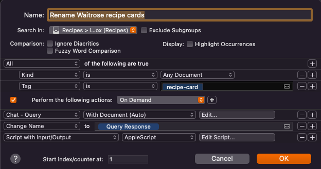

Please post a screenshot of the Rename Waitrose recipe cards smart rule, thanks.
Thanks — here it is.
The AppleScript is
on scriptOutput(theRecord, theInput)
	do shell script "afplay /Users/user/Library/Sounds/Laugh.aiff"
		return name of theRecord
end scriptOutput
(necessary because Play Sound still only allows me to choose system default sounds, rather than anything installed in $HOME/Library/Sounds)
I tested a similar combination of smart rules using the same script and also renaming via AI. Processing multiple selected documents worked flawlessly (DEVONthink 4.2.2, macOS 26.4). Which AI provider and model do you use?
  • In your ScanSnap profile, to where are you saving the documents?

I’m using a local Ollama install with the gemma3:12b model.

That’s the Send to. What is the path you’re saving to?
Ah, sorry – it’s /private/tmp. I think I set it there because ScanSnap left the originals around after sending them to DT4, meaning I ended up with two copies — at least this way, they get cleaned up after a reboot :slight_smile:
Try setting it to ~/Pictures and make sure DEVONthink’s OCR settings have Original document: Move to Trash enabled. That should remove the extra document.
