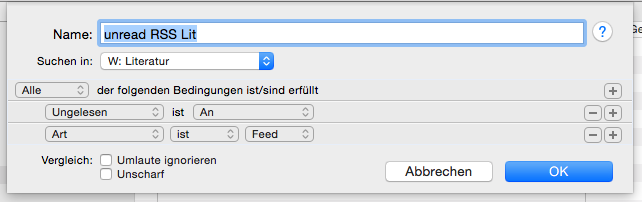

somehow i cannot create a smart group that selects unread RSS. i’m at a loss what the problem is. i can create a smart group that selects any unread item. this includes feed items. but if i add “type is feed” then the group does not select anything. is there a difference between “feed” and “item in a feed”?
see screenshot, this is what i’ve done and which does not work

tom,
switch ‘kind’ from ‘feed’ to ‘html’. As long as your search location contains only feeds, this will not mix with other html stuff.
thanks, that does the job.
so there is no document type “rss item” that one could search for?
your suggestion works fine for me because my feeds are located in only two separate groups. but it is not easy then to have a “global” smart group showing all unread feeds, unless all other unread HTML-docs are concentrated in locations that can be excluded from the search.
