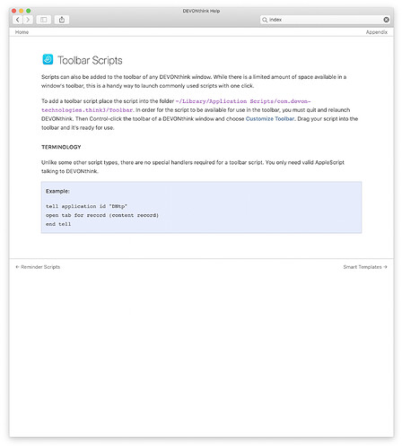

Help > Documentation > Automation > Toolbar Scripts…
I was able to add one of the scripts I like to the toolbar. It works great.
