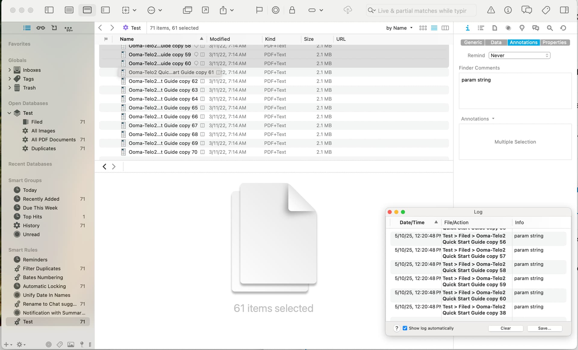

I reset my test setup to anonymize the data so I could be comfortable sharing screen shots.
  1. Here is a screen shot showing the smart rule “Test” and the database after running the smart rule again a subset (60 records). It shows that the rule and called script worked and populated the “Finder Comments” Annotations.

  2. Here is screen shot showing the run with 61 records. and the log. Worked fine.
  1. Then a screen shot run against 64 items. showing no logged items and the “Apply Rules” menu item gone missing. Also the sidebar “Apply Rule” menu item is missing after this run but I spare you another screen shot.
I hope this helps. Perhaps you can recreate this in your own testing?

DEVONthink 4 executed too many scripts concurrently, AppleScript didn’t like this at all :wink: The next beta will fix this.
Thank you for the update. Look forward to the next release.
