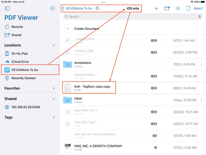

PDF Viewer from PSPDFKit uses the same PDF framework than DTTG. You could a) use the open with from DTTG, do the form fill and then from PDF Viewer return to DTTG or b) use the own PDF Viewer file manager to go into DTTG file system and fill the forms that way (don’t forget to open DTTG to make aware of changes).

So sorry. How do I use the “open with from DTTG”. Are you just talking about using the share sheet in DTTG? If so does that actually open the same PDF in another app (i.e. PDF Viewer) or is it creating and opening a copy of the PDF?
If you go into the external application and it supports the document provider mechanism, you can open files in DEVONthink To Go.
However, that doesn’t necessarily mean the form fields will be supported. That depends on the external application.

Wouldn’t it be possible to open the PDF in another app and fill in the form there? That way, people who need/want it, can pay the other app’s developer.
Yes, and this is currently the suggested method.
