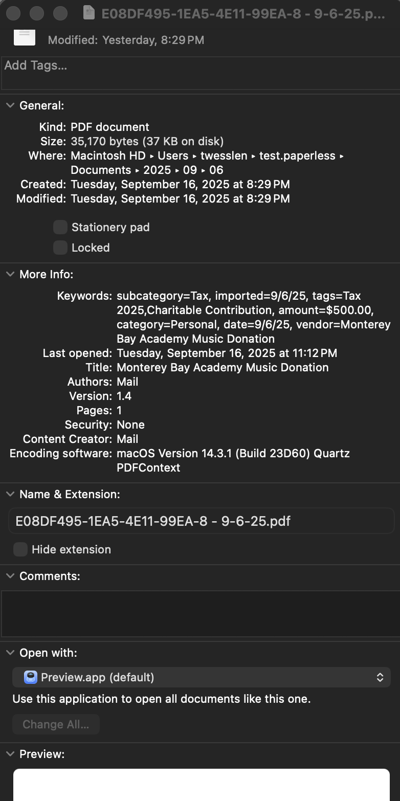

I have PDFs that have had metadata written to them. In the OSX inspector the Keywords have been written and include name=value items, separated by commas. I have no control over how these get formatted so I can’t delimit in any custom way for parsing later.

The problem is that the name=value pairs contain one specific name of “tags” and the value is “value 1,value 2”
Here is an example:
subcategory=Tax, imported=9/6/25, tags=Tax 2025,Charitable Contribution, amount=$500.00, category=Personal, date=9/6/25, vendor=MBA Music Donation

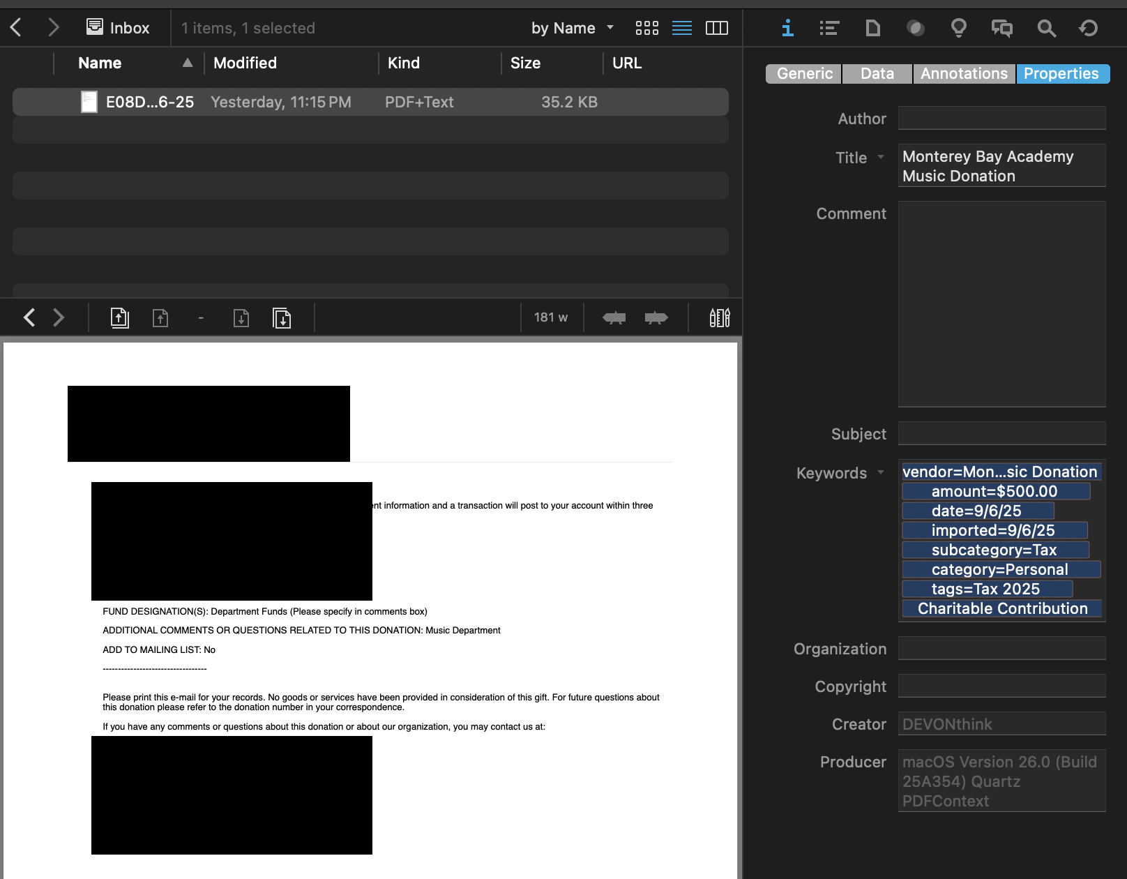

I think that DT mangles the (badly conceived) keywords when it imports the data: What was tax=Tax 2025, Charitable Contribution, becomes tax=Tax 2025 and Charitable Contribution – keywords are comma-separated in DT. I tried it here: In Preview, I could add a keyword like tags=t1,t2, which in DT then appeared as tags=t1 and t2, i.e. two separate keywords.
Your best choice would be to get a PDFDocument object from the file in (AS-ObjC) and retrieve its documentAttributes dictionary. The Keywords entry in it are what one would expect, i.e. tags=t1,t2.
