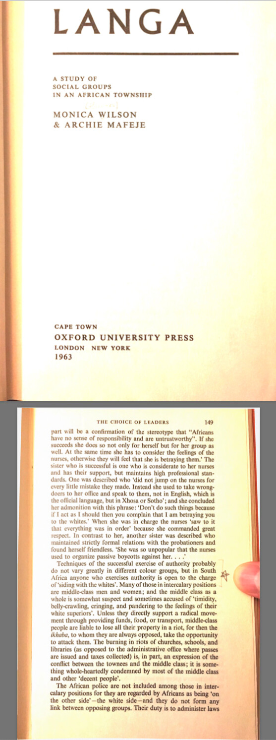

Is there a way to control the page dimensions of a OCR’d PDF generated from a JPG? I sometimes take multiple photos of book pages and then convert them into a single OCR’d PDF document. When I do so, however, the page dimensions vary widely. Here’s an example showing one page with larger dimensions than another:
Is there some way to tell DT to output pages that are all the same dimensions? Is it possible, for example, to configure the output so that it preserves the original image dimensions, or converts all to some pre-specified dimensions, so all pages are the same dimensions?

As far as I am aware there is no such setting in DT; you’d probably need a piece of stand-alone OCR software. Alternatively you might try using an app like Scanner Pro to take the photos and create the PDF in future. Scanner Pro can attempt to determine the page size, and you can change the setting after the fact. To my knowledge DT will then keep that size on OCR.
For your current problem: possibly you could print the PDF to a PDF using a “fit page to” setting? From your images I’m not sure that will be possible without prior cropping.

With the above selections, if I select Print to PDF, then a document made up of different size pages will be resized such that the pages are then all A4 sized. Is that not what you need?
Hot damn–that works! Never did I know the individual pages would grow only individually lol! Thanks!!
