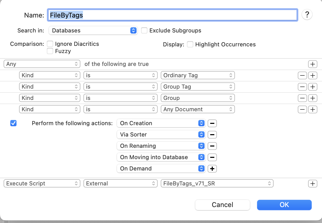

I’m now having trouble just getting perform smart rule to function and realize that I am confused about its use of triggers while operating within a script on a specific record. For example, I am creating a new tag within a script and I want to perform a smart rule on the tag. When I apply the smart rule on demand to the new tag outside of the script, it performs. However, when I run it within the script, nothing happens.
The smart rule is set up as:
The code I am running that doesn’t work is:

The rule is not performed on the new tag.
Is there something I am supposed to be doing with the trigger function? Once the new tag is created, when I apply the smart rule on demand, it works (the script attached to the smart rule is executed).
The smart rule “FileByTags” performs a script which tries to perform the same smart rule again, this is not possible.
In addition, what exactly do you want to do? Maybe a script isn’t necessary at all.
I’m not sure I understand. The smart rule FileByTags performs a script - but that script does not perform the smart rule. The Perform Smart Rule script fragment I posted was a separate script (i.e., it is not the script attached to the smart rule). The FileByTags smart rule performs a script that parses the name of the new tag and files it into specific groups based on certain criteria. I want to run this each time I create a new tag, but since smart rules won’t act on creation events that occur within a script, if I create a new tag within a new script, I need to perform the smart rule within the new script or it won’t act on the newly created tag.
If there is a way to get the smart rule to run even on tags created within a script, that would be great, but I’ve been told this isn’t possible.

Probably the longest script I’ve ever seen Instead of using
perform smart rule
in a script to perform a smart rule which just executes another script it’s actually recommended to execute & load the script directly.
