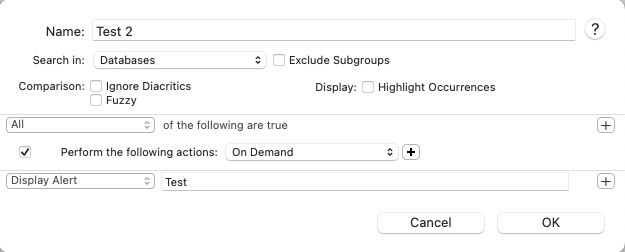

It’s a pretty complex rule that might be irrelevant to this question so I’ve craeted a small test setup with two rules “Test 1” and “Test 2”:
Test 1
Test 2
2022-05-20 CleanShot CleanShot 10.21.45
When running Test 1 as a Smart Rule (Apply Rule - it currently matches 2 documents starting with “1984”) it does nothing. Running the same code (using selection as list) for theRecords) from Script Debugger / Editor it works as expected and shows the alert.
