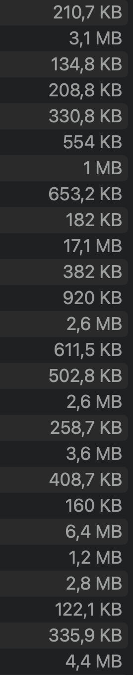

The files themselves vary in size. Some 20MB+ but the vast majority much smaller than that. Here’s a reasonably random sample:
As I said, a large library. If this is just the reality of having 1/3 of a billion words (!) in a database then that’s just how it is. But I want to optimise things as much as I can before I throw an M1 chip at the problem.

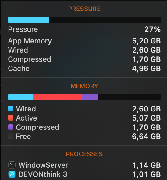

Okay, here’s a memory test:
I quit DEVONthink and reopened. This is the system memory usage when it had just reopened (with all libraries now open but no documents focused or being previewed):
That’s from 16GB total.
I then navigated to the group containing my indexed PDF attachments and browsed through some PDFs in the preview window (some small files, some 20MB+). No lag, no problem, no change in RAM usage.
I then right click to open the contextual menu on a document (any document). Beachball for 10-15 seconds. Here’s memory usage a few seconds after that:
As you can see, accessing the context menu causes a large chunk of information to be loaded into memory that was not there when merely browsing. That would explain the beachball. Once that large chunk has been loaded in, the context menu shows without any delay on any file I select (at least immediately; if I come back later it will lag again).
I should add that accessing the context menu is not the only thing that causes a lag, as described above, but it’s the most easily reproducible method. There’s also a lag that occurs when running a script querying the attachments library that still happens even when the RAM usage is up to around 4GB (and that’s the more serious problem). But I would guess that these issues are connected.
My question I suppose is therefore: is this expected behaviour? There’s clearly headroom in the RAM, the issue is more how DEVONthink loads it in and out. I’d be happy for it to use more RAM in order to get better performance!
