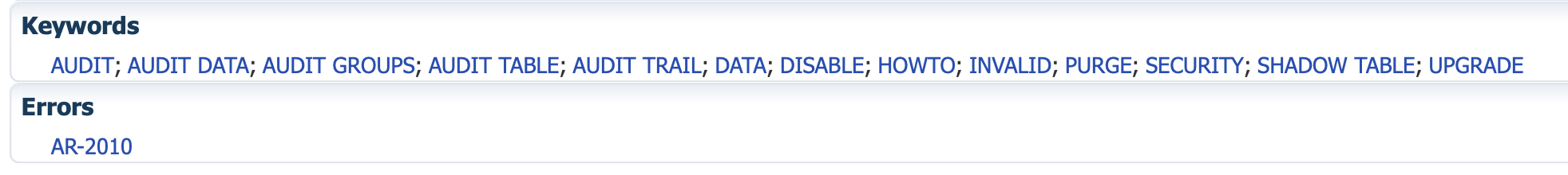

Each document has sections like this …
My script has tagged this record with 14 tags. 13 keyword tags and 1 error tag.
If I click on the “AUDIT DATA” in the PDF keywords this is a link “x-devonthink-item://02493B39-E4D2-446B-980C-A098DD90537D” which takes me directly to the AUDIT DATA tag. Where in this instance I’m immediately presented with 7 documents that are specifically tagged with “AUDIT DATA”.

What are these “sections”? You were speaking of “keywords” before, and keywords are predefined metadata in PDFs. Now it appears that you’re using your own “sections” (whatever that is) in a PDF that you introduce with the heading “Keywords”. In addition, you seem to use another section titled “Errors” to summarize errors. Before, you called these things “keywords”, indiscriminately. That insinuated that you were talking about a kind of metadata, namely the PDF keywords.
No. These are not “PDF keywords”. These are just links in a PDF below the heading “Keywords”. Of course, this is not searchable with docKeywords: AUDIT DATA as a real PDF keyword would be.

The text keywords in the bottom of my PDF such as “AUDIT DATA” start off as text.
My script identifies these text keywords and runs some code “FindOrCreateTag(theKeyword)” which returns the DT referenceURL for an existing tag or creates a new tag if one doesn’t exist but again returns the referenceURL for it. In short, pass it a tag name and it returns a reference URL.
The script then annotates the “AUDIT DATA” text by attaching the reference URL to it. Now when I click on “AUDIT DATA” in my PDF it takes me directly to the “AUDIT DATA” tag in DT where I can see all of the documents I’ve written that contain the “AUDIT DATA” tag.
So one “text keyword” equates to one DT tag. As you can see in this instance this document has 14 “text keywords” so it has 14 links to 14 DT tags.
