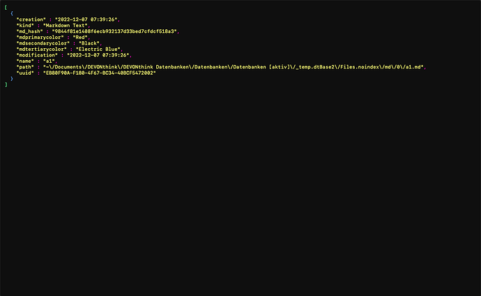

This script creates a JSON file for each selected record.
- property
theCMD_Identifiers
: List of Custom Meta Data identifiers. Add whatever you want.
- property
theOutputFolder_Path
: Path of folder where the JSON files are created.
- property
sortKeys
: Whether the Keys should be sorted. If false
Keys appear in the order they were added.
- There’s a part “Add other key:value pairs here” part where you can add your other values.
Please don’t process all records in one go. You can e.g. set a label or a tag to keep track of what’s already processed. It might be a good idea to create subfolders after each script run because 23.000 files in a single folder might cause problems. Don’t forget to change property theOutputFolder_Path
The JSON filenames are build from the record’s name without extension
plus json
. This means if you would create all JSON files into a single folder and not all your records got unique filenames then the script would overwrite previously created JSON files. To prevent this the record’s UUID
is used when necessary.
