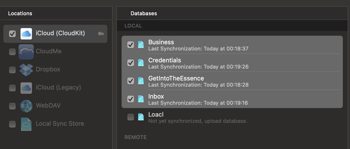

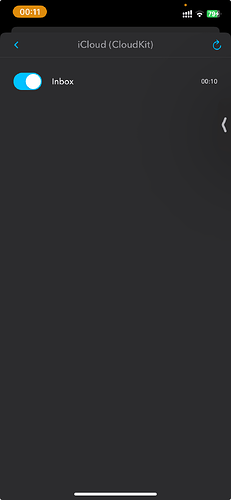

Please help, I just bought the devonthink to go (Yes, I already had devonthink 3 on my Mac), and I can't find any databases in my "Sync Location" but inboxes which can sync
This really strange, there are screenshot.
See! My databases have already synced into my Icloud via devonthink on my Mac, but I can’t see them in devonthink to go except inboxes.

How long did you wait to compare devices? I can see on your DTTG timestamp that your mobile device was synced prior to the sync completing on your Mac (in your DTTG screengrab the inbox sync is timestamped 00:10, whereas on your DT screengrab the syncs didn’t occur until 10 mins later).
In the absence of any other info, I’m inclined to think there isn’t a problem here and it just needed time.
