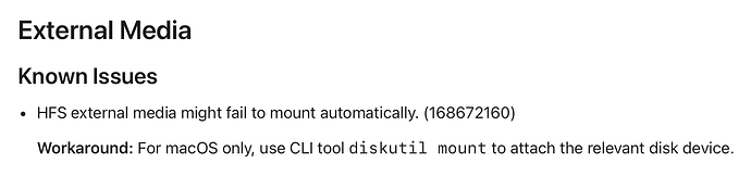

PS: Looking at the release notes for 24.6b1…
Encrypted databases are indeed HFS (MacOS Extended Journaled).

See also Michael Tsai - Blog - macOS 26.4 Beta: Problems Mounting HFS+ Volumes
