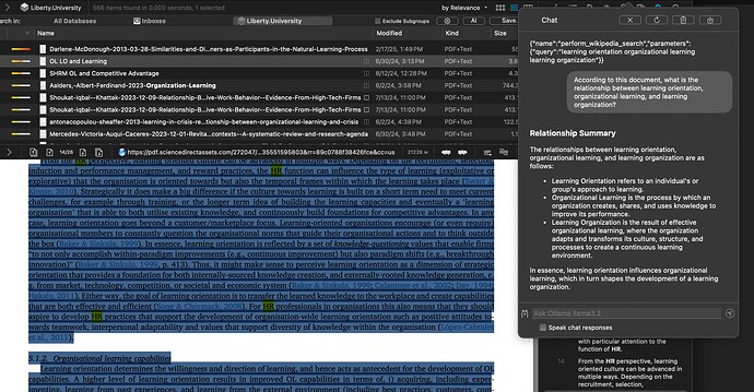

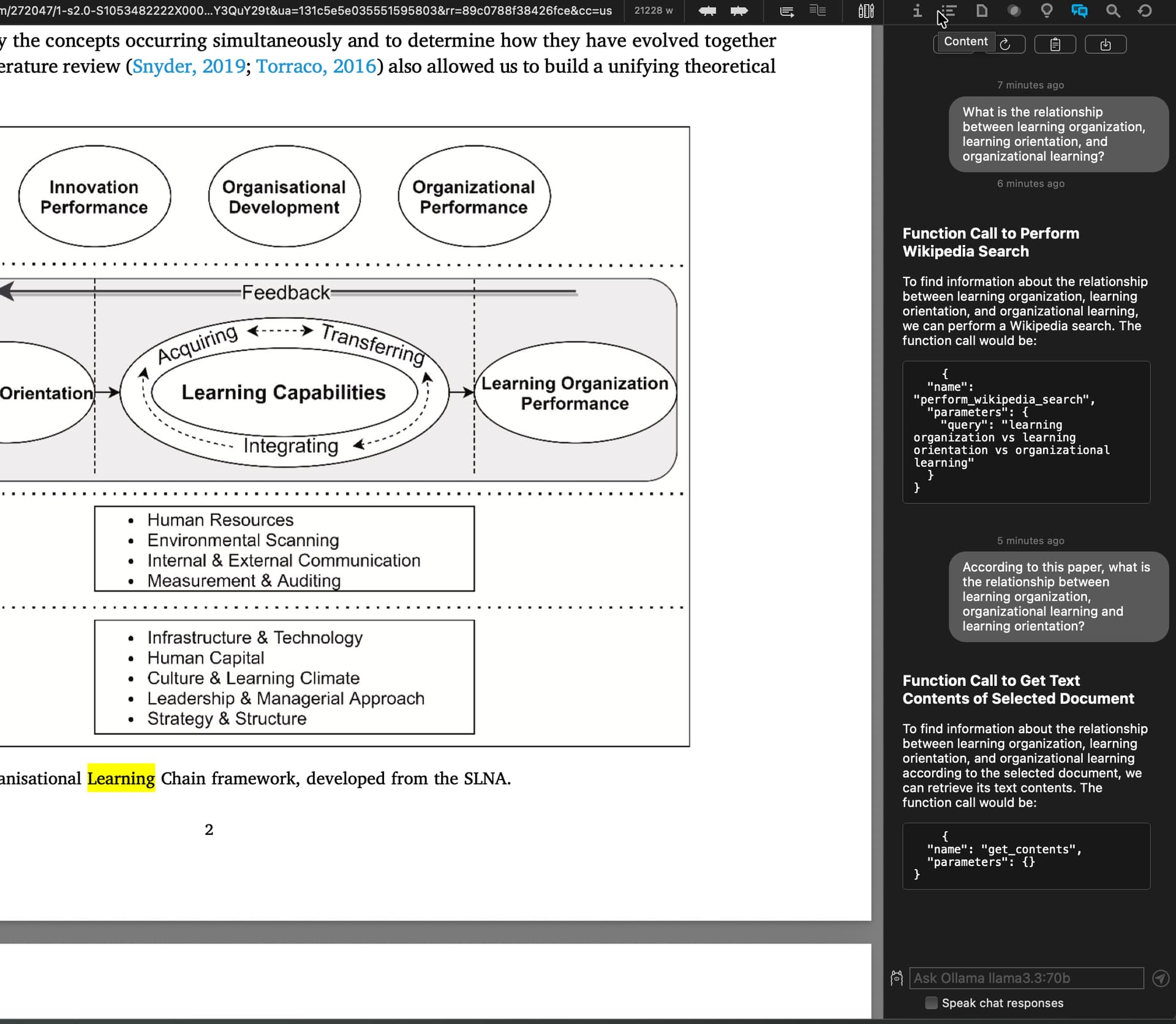

I must be doing something wrong. I open a document, I click on the AI chat button, and I ask the model questions about the document. The model typically responds with something like this:
Function Call to Perform Wikipedia Search
To find information about the definition of darkness, we can perform a Wikipedia search. The function call would be:
  "name": "perform_wikipedia_search",
  "parameters": {
    "query": "Darkness"
Selecting the text of the document and trying the same produces the same results.

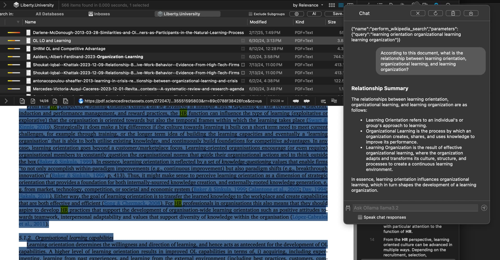

If I use the chat button on the main DEVONthink window (instead of the reader window), and select the text, it answers my questions based on the selected text.
Intuitively, it seems I should be able to use the GenAI model to “talk” to the document when it is open in the document reader.
Am I doing something wrong?

Actually that’s not the case, it’s intended that contents are only sent if requested and if the model supports tool calls to save tokens & time and to improve the privacy. Therefore the initial issue was caused by invalid tool call responses, despite Ollama claiming that the used model should support them.
I would highly recommend Mistral 3.2:27b, Gemma 3:24b, GPT-OSS:20b or Qwen 3 instead. LLama 3.3 is kind of dated by now.
