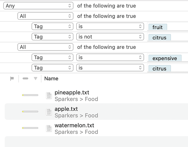

Can I write a query that will return results if the following conditions are met:
ONLY fruits are allowed AND
citrus fruits are NOT allowed, UNLESS they are also expensive
So for the above example it should return apple, pineapple and watermelon

I have looked at them. But I do need to form a query first that gives the results I want.
Where I am stuck is in this part:
(Not citrus) or (Citrus and expensive)
Or is “any” in DT, and is “all”
But a pineapple is not a citrus. So, you can’t get the result you want anyway :winking_face_with_tongue:
What you’re trying to do screams for a relational database. And for a proper data model. Loudly.
Welcome @easterbunny
Per your specific example…
This works perfectly. Thanks!
