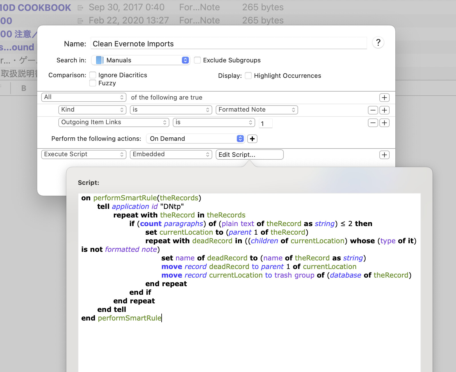

Here it is. It is the very same smart rule linked in this thread. I’ve changed the paragraph count verification from “=1” to “<=2” because some formatted notes contain an empty line (not all of them though).

I lifted the error handling code from one of the examples attached to DEVONThink. I tried applying it at different stages, with no difference. The last version I tried was this:
			try
				if (count paragraphs) of (plain text of theRecord as string) ≤ 2 then
					set currentLocation to (parent 1 of theRecord)
					repeat with deadRecord in ((children of currentLocation) whose (type of it) is not formatted note)
						set name of deadRecord to (name of theRecord as string)
						move record deadRecord to parent 1 of currentLocation
						move record currentLocation to trash group of (database of theRecord)
				display alert "DEVONthink" message error_message as warning
			end try
end performSmartRule
