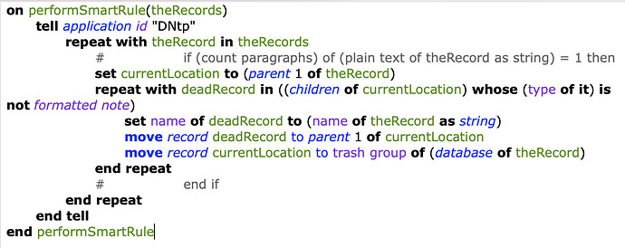

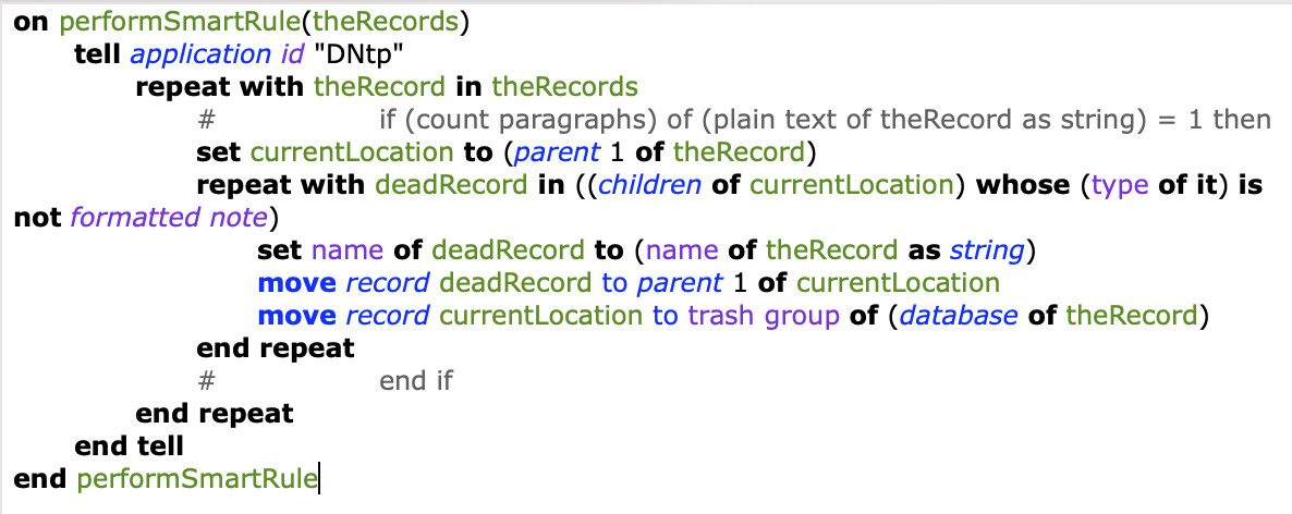

I applied the script successfully. However, I had too many notes where the rule didn’t work.
I have therefore duplicated the rule and commented out the if and end if lines with a # like this:
I gave it the name “Clean Evernote Imports!”.

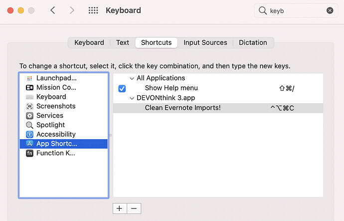

After that I went to System Preferences → Keyboard and gave the resulting menu item a shortcut:
Now I can apply the rule easily when I get any of the many notes with the issue.
Note the first line of the script: On PerformSmartRule(TheRecords)
It’s a handler that’s triggered within Smart Rules
You will need to add a line for retrieving “TheRecords”, and triggering the handler

Add the line; tell application id “DNtp” to my performSmartRule(the selection)
Will gladly do. But it does work already. Is this line really needed then?
