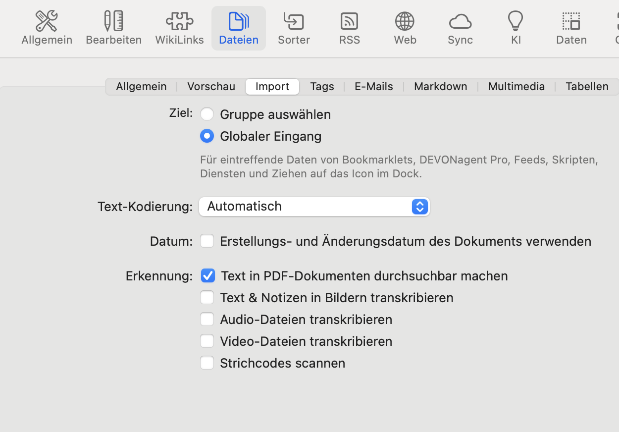

That’s the preference I was referring to:
Files/Import …
Here’s what the manual says about it:
Transcribe PDF documents: PDFs without a text layer are automatically processed via the Vision framework.
I just turned that off here, imported your file and checked r.wordCount() – was 0, as it should be.
Text is still selectable in DT, though. But that’s probably the part of Vision that can’t be turned off in DT because it Is Good For You™

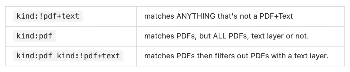

Following a comment from @cgrunenberg, here is a small matrix of raw queries related to the topic:
And yes, those are usable with a search script command (for those who may not know).
While that’s possible, this would require changes to existing scripts. And doing a search is not quite the same as iterating over a list of selected records to filter out files with(out) a text layer.
