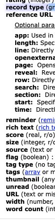

Look in the scripting dictionary, it’s all listed there :slight_smile: type is a property of record
I cannot see in the .sdef where it says what file types are of record type “picture”, so would appreciate a pointer to that. For example, I know PDFs are not, but “.pict” files are, etc. I’m trying to find that definition.
Just to be clear, is this the record definition you’re talking about?:
Under that is the record type section I posted earlier, which has a valid value of “picture” (amongth “group/‌smart group/‌feed/‌bookmark/‌formatted note/‌HTML/‌webarchive/‌markdown/‌txt/‌RTF/‌RTFD/‌picture/‌multimedia/‌PDF document/‌sheet/‌XML/‌property list/‌AppleScript file/email/unknown”) – so what types of “pictures” does “picture” include?

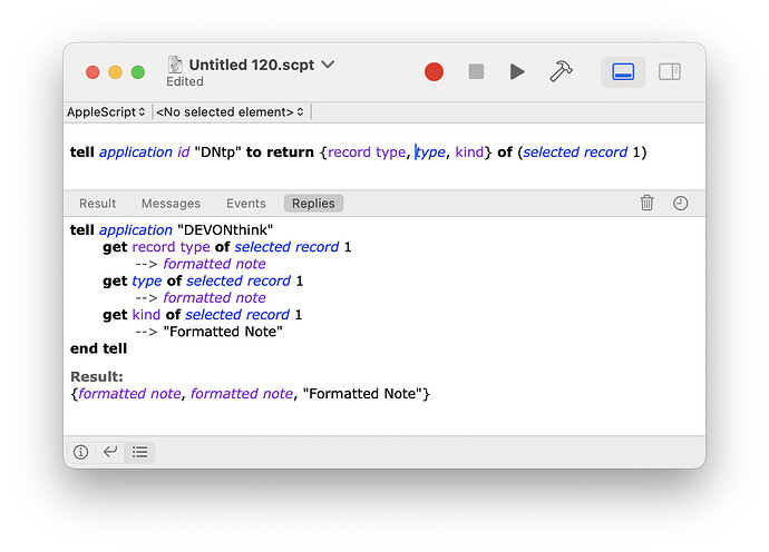

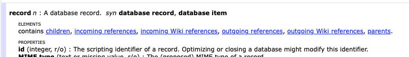

No, it’s not.
record type is a property of record.
no type property there.
type is used in DT3, in DT4 it’s called record type and that is a synonym for type:
From the sdef file (not what script editor shows you).
<property name="record type" code="DTrp" description="The type of a record. WARNING: Don't use string conversions of this type for comparisons, this might fail due to known scripting issues of macOS." access="r">
    <synonym name="type" code="DTty" hidden="yes">
          <cocoa key="type"/>
    </synonym>
    <synonym code="type">
           <cocoa key="type"/>
    </synonym>
    <type type="data type"/>
        <cocoa key="type"/>
</property>

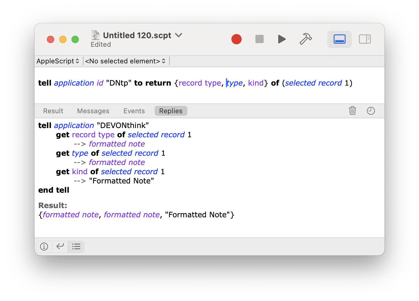

@chrillek is spot on with is response.
In a smart rule, batch process, or search, Kind is essentially equal to type, e.g., it’s an Image not a JPEG. Specific file types would be the extension.
In scripting, kind is what you’d see in the Finder, e.g., Formatted Note. record type or type is an internal non-localized property.
Since this is a localized value, we generally recommend using record type or type.

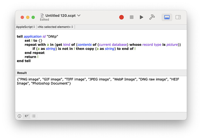

PS…

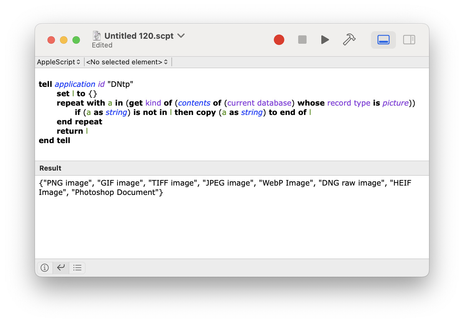

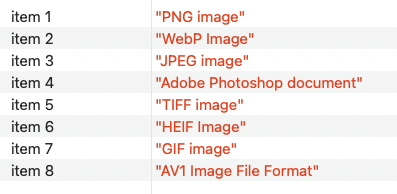

… and here. Interesting, why do you get “Photoshop document” and I do “Adobe Photoshop document”?
It’s what’s reported by the Finder. And I don’t have Photoshop installed on this Mac.
Hm. Interesting.
But that is not a comprehensive list, just what is currently in your database.
