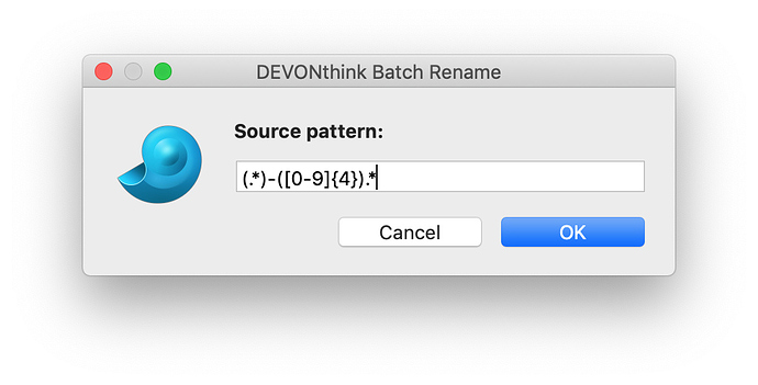

I tried the batch rename script with the source pattern:
^(.*)-(\d{4})

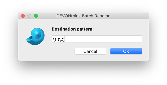

and destination pattern:
$1 ($2)

That is the incorrect form. It’s BSD sed under the hood.
Use this source with an explicit range…
And again, I’m not advocating parens, but you can use this destination pattern…
