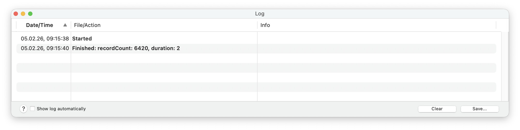

DT 4.1.1:

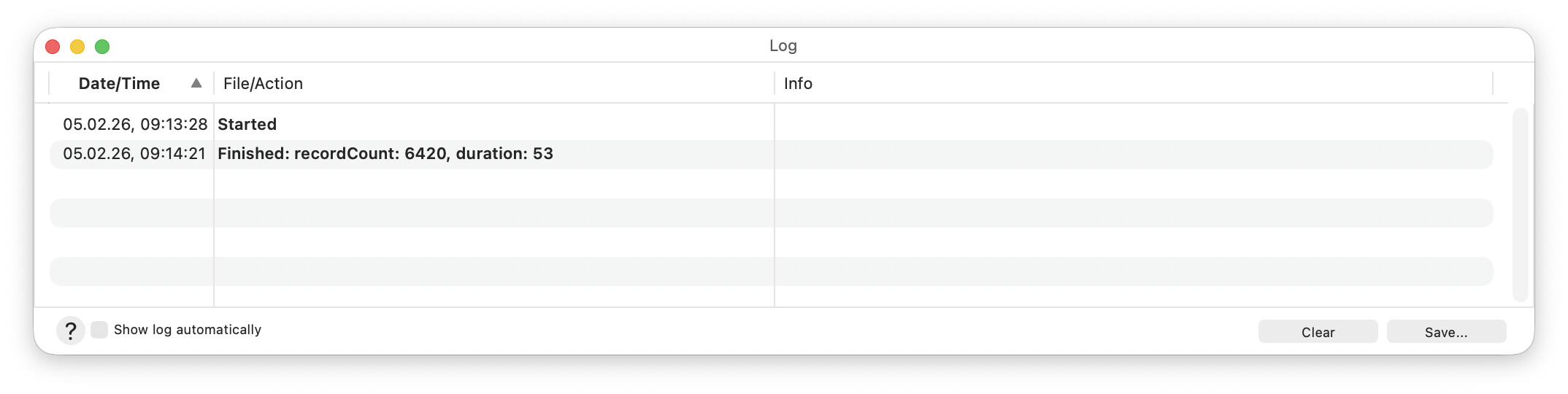

DT 4.2:

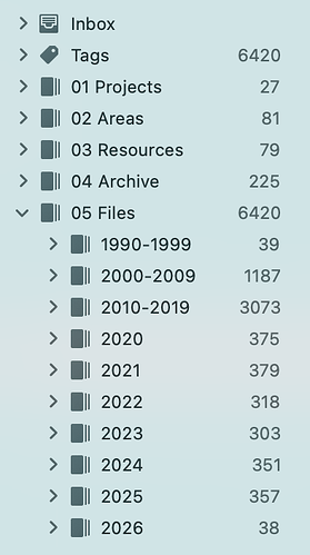

Database Structure/Outline:

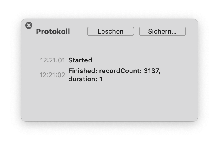

I’ll have to test this on Tahoe too but at least on Sequoia the performance of both versions is identical (as expected). How exactly did you run the script? Via the Script Editor.app? The Scripts menu of DEVONthink? Or the global scripts menu extra?

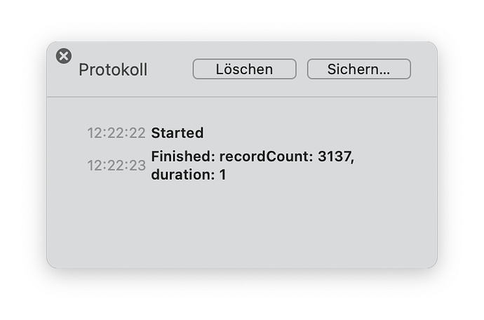

DEVONthink 4.2:

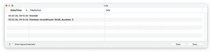

DEVONthink 4.1.1:
On Tahoe I could reproduce the issue. But a sample of DEVONthink while executing the script didn’t reveal any real bottlenecks, DEVONthink used only 10-15% of one core. Closing all windows didn’t make a difference too.
