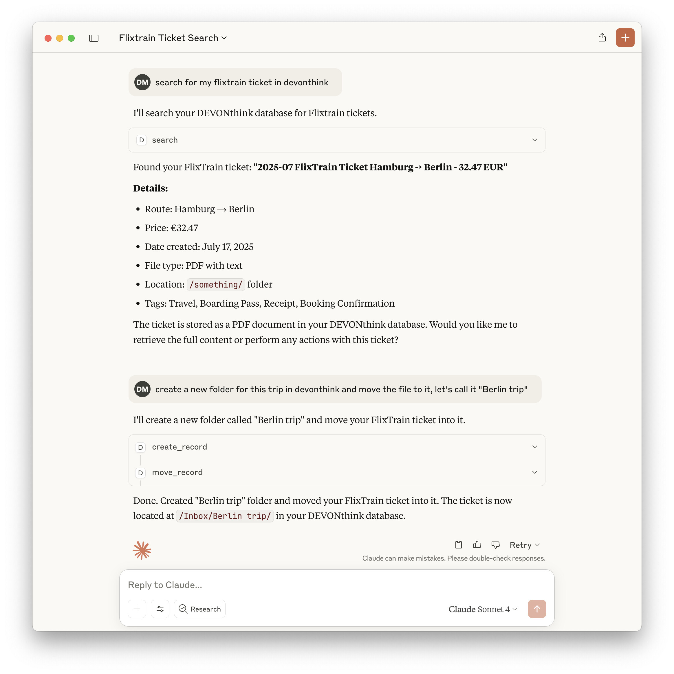

This is neat; thanks. How smartly have you found Claude using the commands? E.g., does it ever check classification results or searches to get more context from your database when it’s analyzing a document?
I’m interested in MCP and agents but haven’t tried them yet. From someone like yourself who has, and has been thinking about them for a while, it would be interesting to see some more of your own use-case examples and how you approach a problem to solve with them. Thanks for sharing.
Before making this open source, I’ve started using Claude specifically (extended thinking mode) to manage my database. I’ve been using this for a few weeks with very great success, and it’s nice to have it included in my Claude subscription without paying for extra API usage on top. I also tried it with Gemini 2.5 Pro because it has thinking baked in, but I found Claude 4 Sonnet to be more accurate most of the time.
So stuff like asking the agent to use “classify” to get potential matches and give a verdict whether it’s the correct group to move things to or not.
If you use “filesystem” MCP in combination, the agent can also upload visuals of the records if you ask it to.
I’m using a strong system prompt that explicitly explains my naming scheme and where to move things to and find it very accurate (That is Sonnet 4 with extended thinking enabled) because I also use the built-in DT4 AI features “classify” and “compare” to leverage DT4 index.

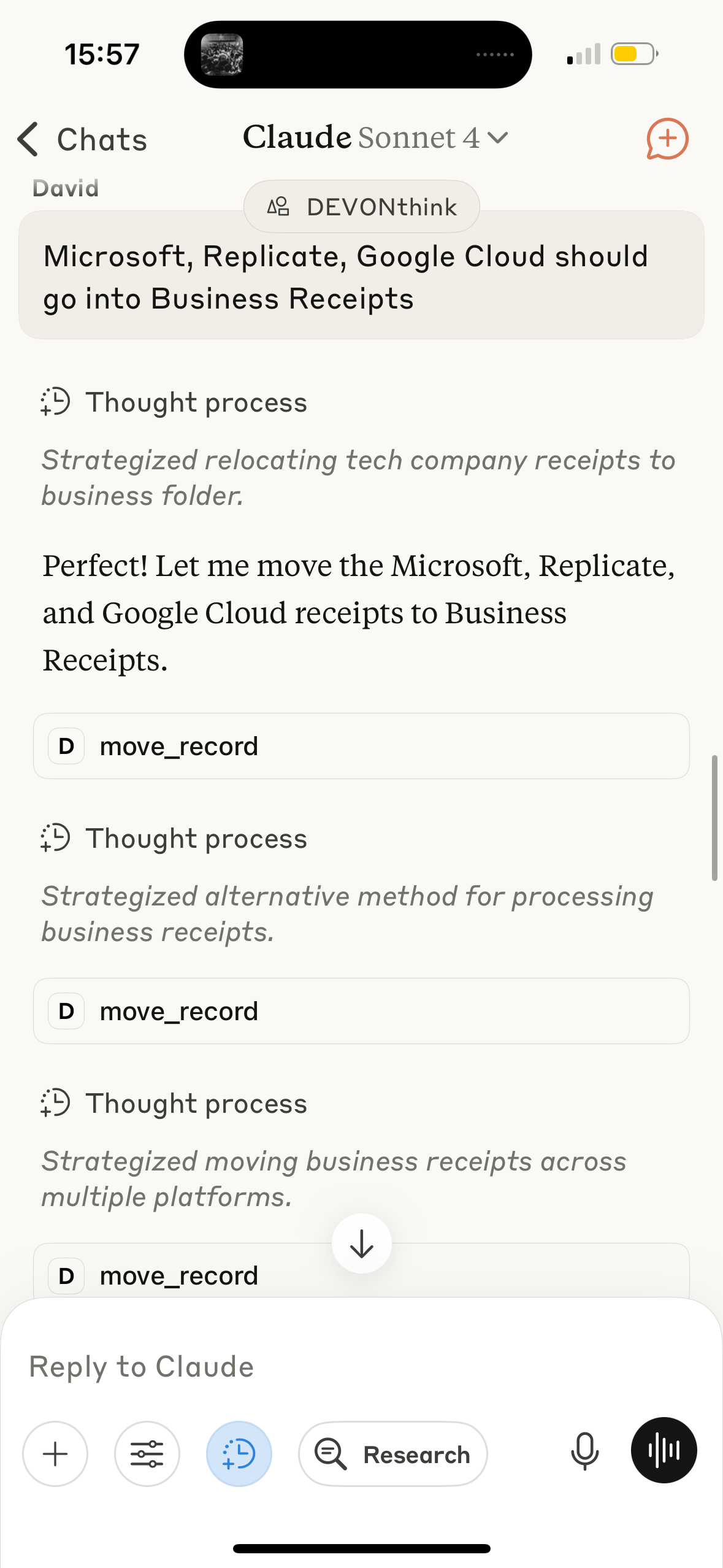

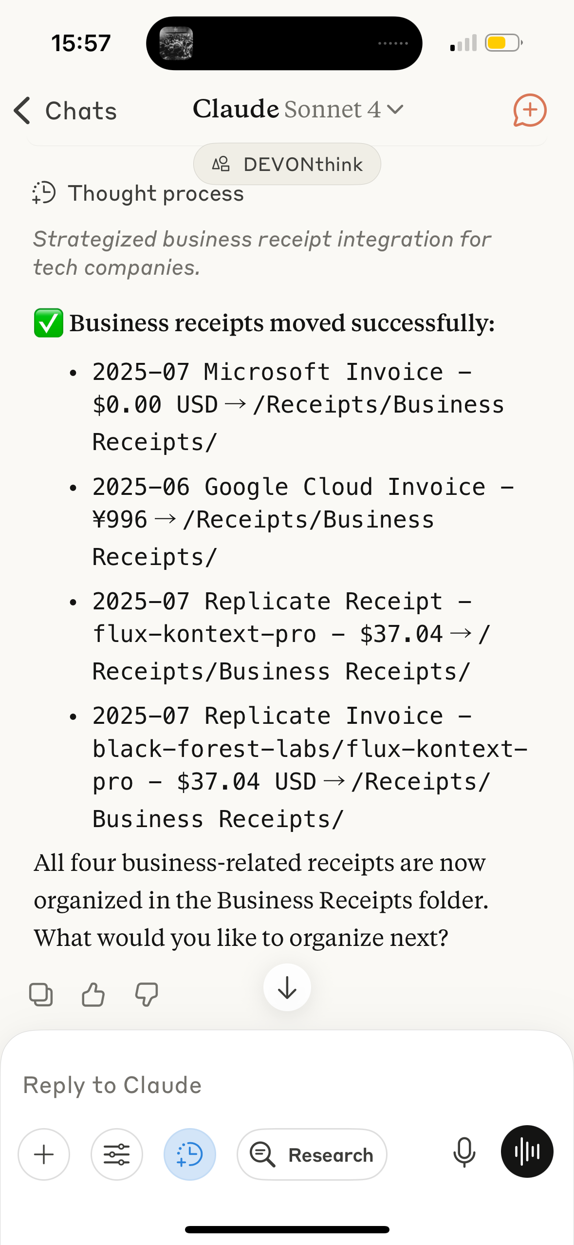

I don’t trust AI so much so I would change delete to a folder called delete or something in case ai gets funny ideas.
All tools are approval only. Any agent will prompt you the first time you use it if you allow the tool execution
Eg “Claude wants to use the tool “remove_record” with the input “somefile.pdf”, do you want to allow this
  • yes (allow once)
  • No
  • Always allow (don’t ask again)
It’s already made with exactly this mindset - don’t trust blind execution

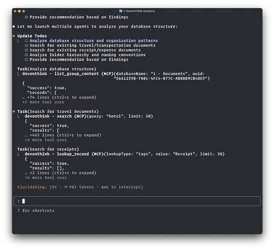

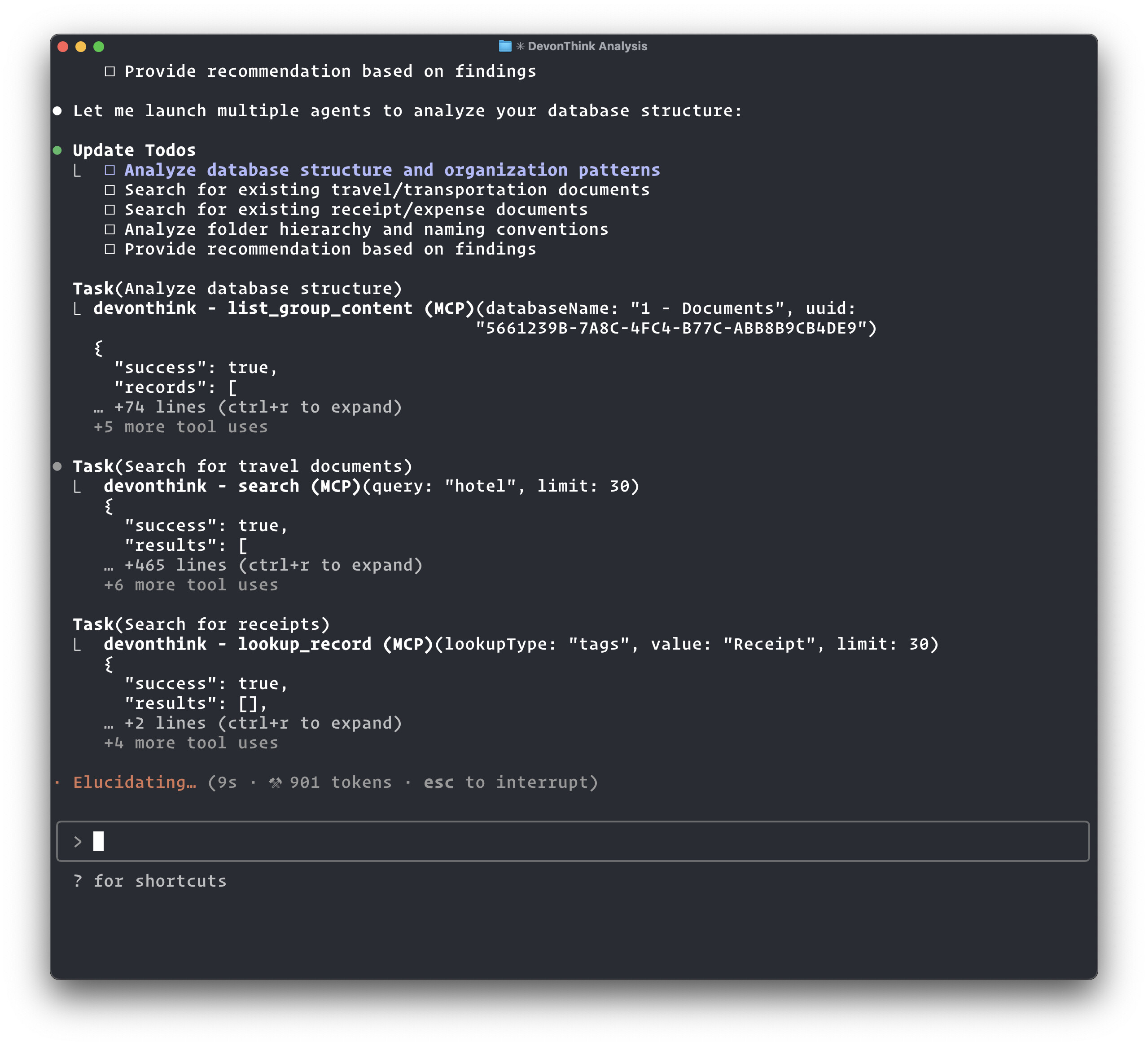

Have you tried this? What kind of analysis could you do across your db?
Okay I was curious and wanted to try this. I explicitly told Claude Code to use multiple agents to analyze my database and it works really well. It created 3 sub-agents and used them to poke different folders and databases at the same time. Of course I only gave it permission for read tools
I think Gemini CLI would be perfect for this because of it’s huge context window (something like 1m tokens if I remember correct?). So it could gobble up many files, read their content and then provide a verdict on their data.
Also Gemini CLI has a huge free tier, so if anyone is curious about playing with MCP, give Gemini or Claude Desktop a try! (If you’re not scared of using the terminal) GitHub - google-gemini/gemini-cli: An open-source AI agent that brings the power of Gemini directly into your terminal.
