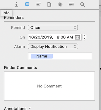

A screenshot of the reminder would be useful. In addition, was the computer awake and DEVONthink 3 running?
The script is a repeating reminder that is supposed to run at 6am. It sometimes goes off and sometimes doesn’t. I am usually on my computer by 5am, though not everyday and DT3 is always open when I am on my computer. It often goes off around 2:30 or 2:50pm, and sometimes in the morning, and sometimes it seems to run twice in one day and other days does not run. I haven’t quite figured out if those correlate to the days when I am not on my computer at 6am.
Here is the reminder screenshot:

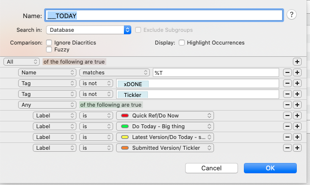

What does your smart group look like?
Here are some screenshots. I actually also gather things labeled red and yellow so I can prioritize tasks by changing the label. The orange tasks are things that have been populated based on reminders running my script.
