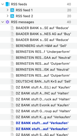

In order to show you the problem, consider the attached screenshot below. There are two RSS feeds (“RSS feed 1” and “RSS feed 2”). The smart group just lists all RSS messages from these two feeds. Most messages are distinct; however, there are two duplicates, that is, a message that occurs in RSS feed 1 and 2.
I receive hundreds of RSS messages a day; quite a number are duplicates. Currently, I have to select all of them in the smart group and convert them to replicates manually. This is what I want DT4 to do automatically. With replicates I avoid multiple appearances of the same message in the smart group.

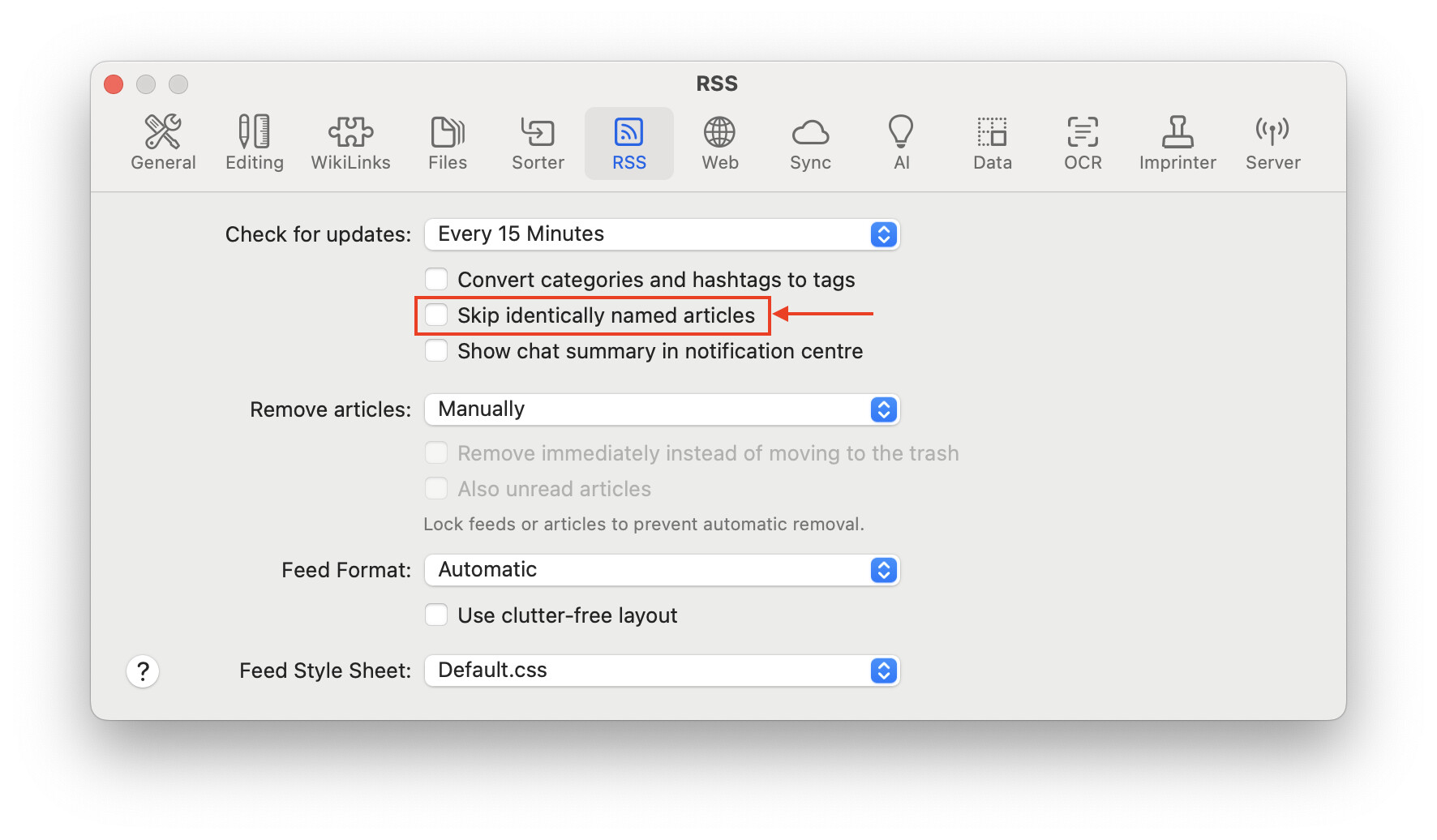

Do you have this enabled…

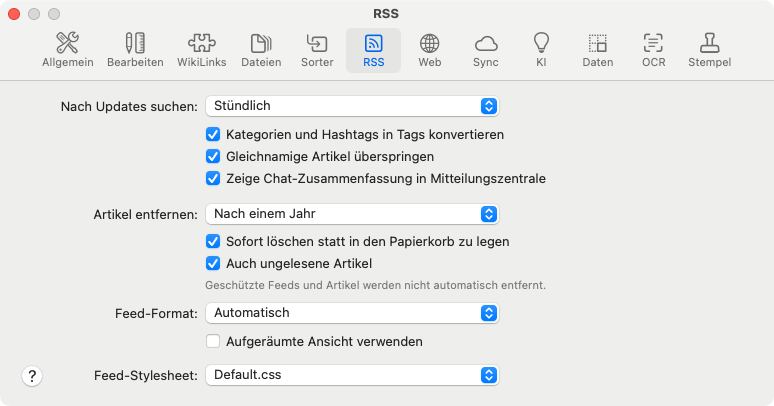

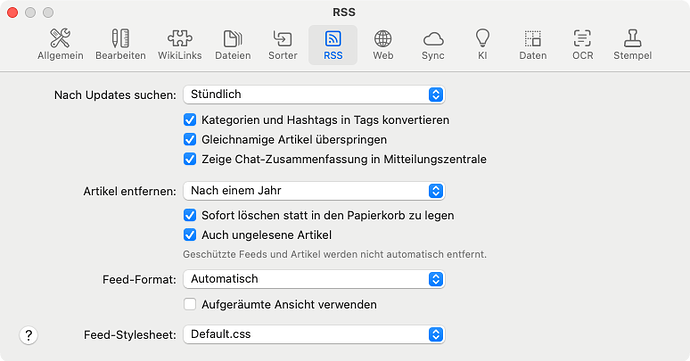

Yes, see below. – Perhaps this option only applies to identically named articles in the same RSS feed? This is not the case for me. I receive the same RSS message in different RSS feeds.
Development would have to respond on this but IIRC that option was added to alleviate the same article being published by multiple feeds, e.g., if you subscribed to specific feeds from Apple but also the hot news feed that would include some of the same articles.
No, this option is limited to each feed.
