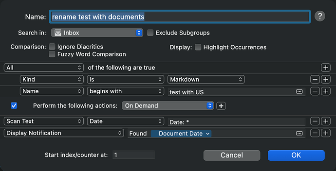

I have created a markdown text document with the following content:
test with US dates
Meaning Dec 1 2022
Date: 12/01/2022
I am myself in the Netherlands and my default date format is as follows:

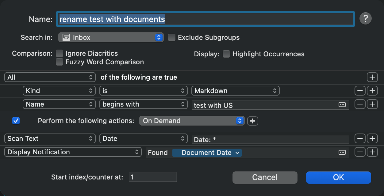

I have created a smart rule with the following settings:
When I run this smart rule, I get the wrong value being 12 Jan 2022.
However when I change the date format to the following:
and run the rule again I get the value 1 dec 2022.
In other words the scanner follows the system settings. If you have mixed values you will have to use regular expressions to capture the individual components and use those to manually craft the proper date.

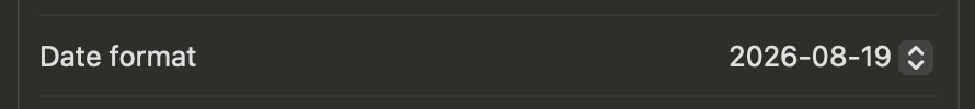

I checked my setting and it was:
This produced the awry results outlined in the opening post.
As per your hint, I changed the date format to:
Screenshot 2026-01-13 at 12.04.40
Restarting DT and applying the smart rule to my document, this resulted in 11/01/22 now being ignored as the latest date in favour of correctly identifying 31 January 2022 as the latest date, and returning 2022-01-31 in the renamed file (which is result I wanted in the format I wanted!) instead of the erroneous 2022-11-01 previously.
So does this mean DT will correctly interpret dates if the Date Format setting in System Settings is ‘appropriately set’ (in the format the dates appear in the subject document) and not only support MM/DD/YY; the latter as indicated by @cgrunenberg in an earlier post?
I would prefer my system setting to be YYYY-MM-DD as I find in an ordered list of dates it is logical to my eye and will sort correctly when read as text (and it’s the ISO standard). However, to make running this rule work I could flip this setting to DD/MM/YYYY and change back later.
Thank you for showing the significance of the Date Format in System Settings to this outcome. It solves my problem for this particular financial institution’s statement.
