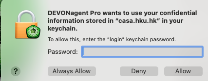

Reset login keychain
How to reset/ update DA Pro keychain - as screenshot
with thanks, Justin
That’s not DEVONagent. It’s Keychain Access asking you to allow DEVONagent permission to use a stored credential. So what do you actually want to reset?
Does one of your search sets try to automatically send emails?
That makes sense (that it is Keychain asking for access to DEVONagent to use a stored premission) - and that one of my search sets (set up some years ago may be set to an email).
However, I cannot see within DEVONagent any search set that has an email connected to it, nor anywhere in DEVONagent that sets up such an action.
The “Email” option in Settings goes straight to triggering the password request - so how can I “get ahead” of this request and reset?
thanks, Justin
Did you check Window > Search Sets?
Deny the request once, then select the Apple Mail option in Settings > Email
