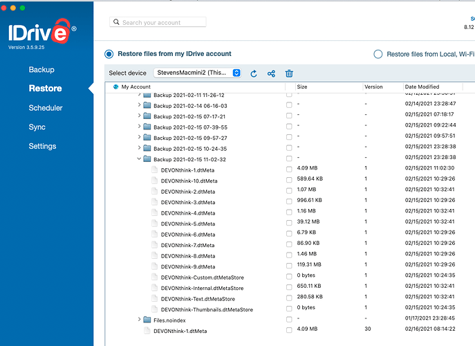

In the second case I would need to restore from iDrive. Unlike Time Machine, iDrive shows the metadata folder contents of the .dtBase2 file. I notice that iDrive does not show the Backup folders within the .dtBase2 folder, yet they show as selected within iDrive. When I click on the Backup Date, all the metadata files are included as default. Would I also need to include the Files.noindex folder?

We don’t use iDrive but this backup looks incorrect. The package isn’t intact. You should have a.dtBase folder containing these items or better yet, just the dtBase2 package intact.
And this .dtMeta file at the bottom is copied outside the structure…
So no, this definitely does not look correct.

So, for recovery from MacMini failure, I was only concerned with being able to recover my data after DT was re-installed. And similarly for my remote backup plan, I was only trying to backup the database files (all files within the Database Folder). And so I instructed iDrive to do daily backups, but only the Database folder and all files, including within it. 2 Screen shots from within iDrive follow indicating the Files within the Database folder and those within one of the backup file folders.

Okay that looks a bit better in iDrive, though I don’t know if iDrive is package-aware. It may be worth it to restore a database and open it to see if it’s intact. Doing a File > Verify & Repair on it after restoring would be a good idea too.

Sounds like I need to follow up with iDrive and the package-aware feature.
