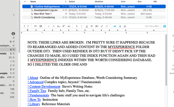

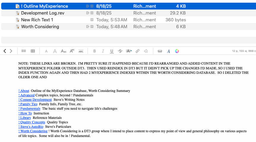

I just upgraded from DT3 to 4. The appearance of text font size, of my RTF files is now too small to read How can put things back to the way they were? Screenshots attached. Top one is the appearance in DT3 and the bottom one it the DT4 appearance.
Since the font size in the RTFs haven’t changed, there must be some setting to change the zoom for the DT4 displayed appearance of the RTF’s.
