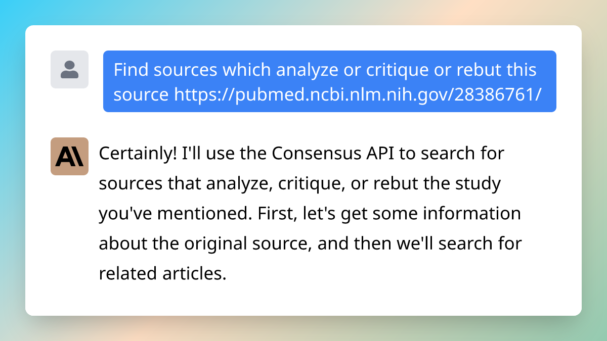

This is only distantly related to Devonthink at this point - but the end result does end with “Save to Devonthink” and certainly a good number of those who use Devonthink are interested in its application in academic and related professional work.
TypingMind is a AI front-end which allows use of multiple language models and also allows use of custom plugins to enhance the capability of off-shelf LLMs.
Consensus.app is an outstanding AI-driven search engine which retrieves academic citations in almost any field. They have recently relased a beta API.
I configured their API to work with TypingMind. The result is an impressive ability to analyze, critique, and/or rebut academic articles. [And then save the result to Devonthink.]
